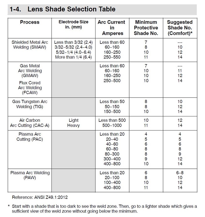

Welding shades:
Determine how dark the welding filter gets when the welding arc is struck. Market standard shades are 8-13 with 13 being the darkest. See the chart below to determine the correct shade number for your welding applications.
