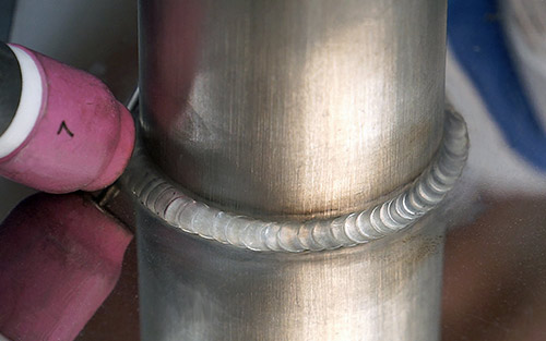

When should you use pulsed TIG welding?
Pulsed TIG welding is ideal when excessive heat could cause problems. The more heat that goes into any weldment, the more likely distortion (warping) will become a problem. This is most noticeable on thin metal sheets and on metals with relatively low heat conductivity, like stainless, and high-tech nickel alloys, like Inconel and Hastelloy. When the heat of a weld isn’t dissipated by good conductivity, it keeps the weld and the adjacent heat-affected zone at a higher temperature for a longer time, causing more distortion.

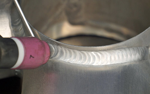

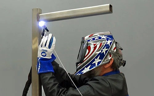

Another instance where pulsing can really help is when welding out of position. Gravity always wants to pull a liquid weld downward, and if you’re welding overhead, this can be quite problematic. Pulsing helps keep the puddle attached to the metal and lessens its tendency to fall toward you as you’re welding. We’re sure you can see the benefit here!

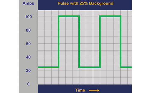

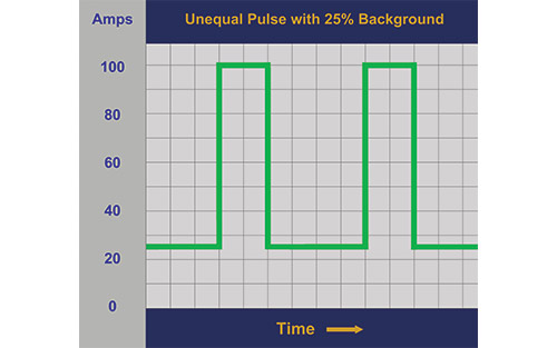

A pulsed TIG welder alternates between two current levels:
  • Peak current – the highest amperage in the cycle
  • Background current – a percentage of the peak value
On basic machines, you set the peak amperage and the background defaults to about 25% of that value. Pulse frequency — the speed of the cycle — is also adjustable.
Advanced machines offer more control, letting you fine-tune the background percentage and even the time spent at peak versus background.
For example:
  • If the peak is set to 100 amps and the background is 25%, the background current equals 25 amps.
  • If the peak is set to 60 amps and the background remains at 25%, the background current equals 15 amps.
This flexibility allows welders to tailor heat input and puddle control for different applications.

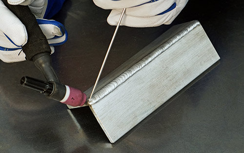

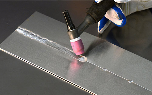

While pulsing at any frequency will lessen the total heat input, there are distinct characteristics available at different points in the spectrum. Some people use a very low pulse frequency (around one pulse per second) to time the addition of filler rod. This is like a musician using a metronome to keep accurate time with the music. Most welders hold the torch stationary and add filler rod during the peak portion of the cycle, then retract the rod and advance the torch during the background period. This is also an excellent way to accentuate the “dime on dime” look that many people prize as the hallmark of a beautiful TIG weld.

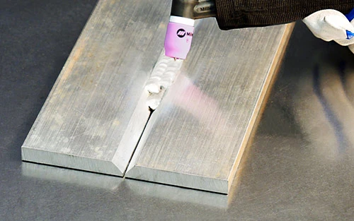

Very low frequency (one pulse per second)
Very low frequency may be beneficial when making a pass over a weld that has an uneven bead profile. The slow, even pulsing can add a regular ripple pattern that wasn’t there previously. Filler rod is not generally added when using this technique.
