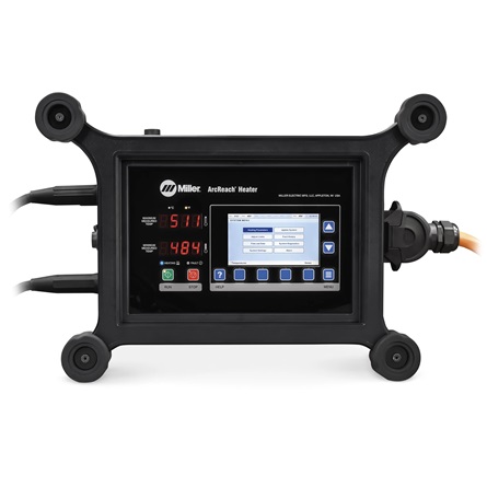

ArcReach® Heater
301390
Portable air-cooled induction heating system for preheat and bake-out applications up to 600 degrees Fahrenheit (315° C)

Compatible for select ArcReach welding power sources. Use existing on-site welding equipment up to 200 feet away as the heating power source. ArcReach technology increases jobsite productivity and efficiency by eliminating the time spent to walking back to make adjustments.   Learn More
Integrated Temperature Recording for Quality Control Requirements
Automatically and accurately documents joint temperature every time a heating cycle is completed. Export data and create temperature charts with ArcReach Heater Data Application.   Learn More
Easy to Use and Set Up
Welders will find the system intuitive to set up, use and tear down the system without having to wait for the tools to cool down. Heating profiles can be manually entered or loaded via USB drive using the Data Application.   Learn More
Powered by On-site Welding Power Sources
Enables welders to use the same equipment used for welding. Utilizes standard weld cables to power the ArcReach Heater and eliminates the requirement for expensive power drops.
Temperatures up to 600° F / 315° C
Ideal for preheat and bake-out applications on pipe, plate, or odd geometries. Induction heating provides a fast time to temperature, consistent quality and even heat zone controlled throughout the part.
Choice of Two Heating Tools
Air-Cooled Cables (available in 30 ft, 50 ft, or 80 ft lengths) are flexible to be used on pipe, plate or odd geometries. Air-Cooled Quick Wrap is a simple tool for pipe applications 10 inches OD and below.
Lower Heating Expenses
The ArcReach Heater System eliminates the costly overruns common with heating contractors and allows contractors to regain control of heating costs and timelines.   Learn More
Minimize Safety Risks
Eliminates safety concerns caused by traditional open-flame heating and resistance heating.

General Specifications
Title ArcReach® Heater
Industries Interests Shipbuilding
Output Frequency 5 - 30 kHz
Rated Output 7.8 kW at 100% duty cycle
Output Current 200 A
Output Voltage 300
Maximum Temperature 600° Fahrenheit / 315° Celsius
Source Current 33 A
Portability Handle(s)
Strap
Applications Refineries and Power Plants
Structural Welding
Tube and Pipe Fabrication
Net Width 11.2 in
Net Height 18.6 in
Net Length 26.7 in
Net Weight 43 lbs
Warranty 1 Years
