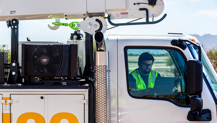

The CabEn cool keeps an operator cool in the cab without having to idle the truck.

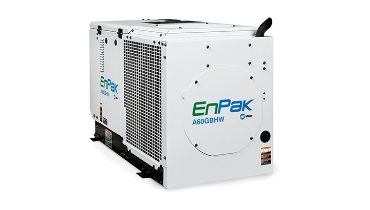

The EnPak all-in-one solution creates a complete anti-idle system.
