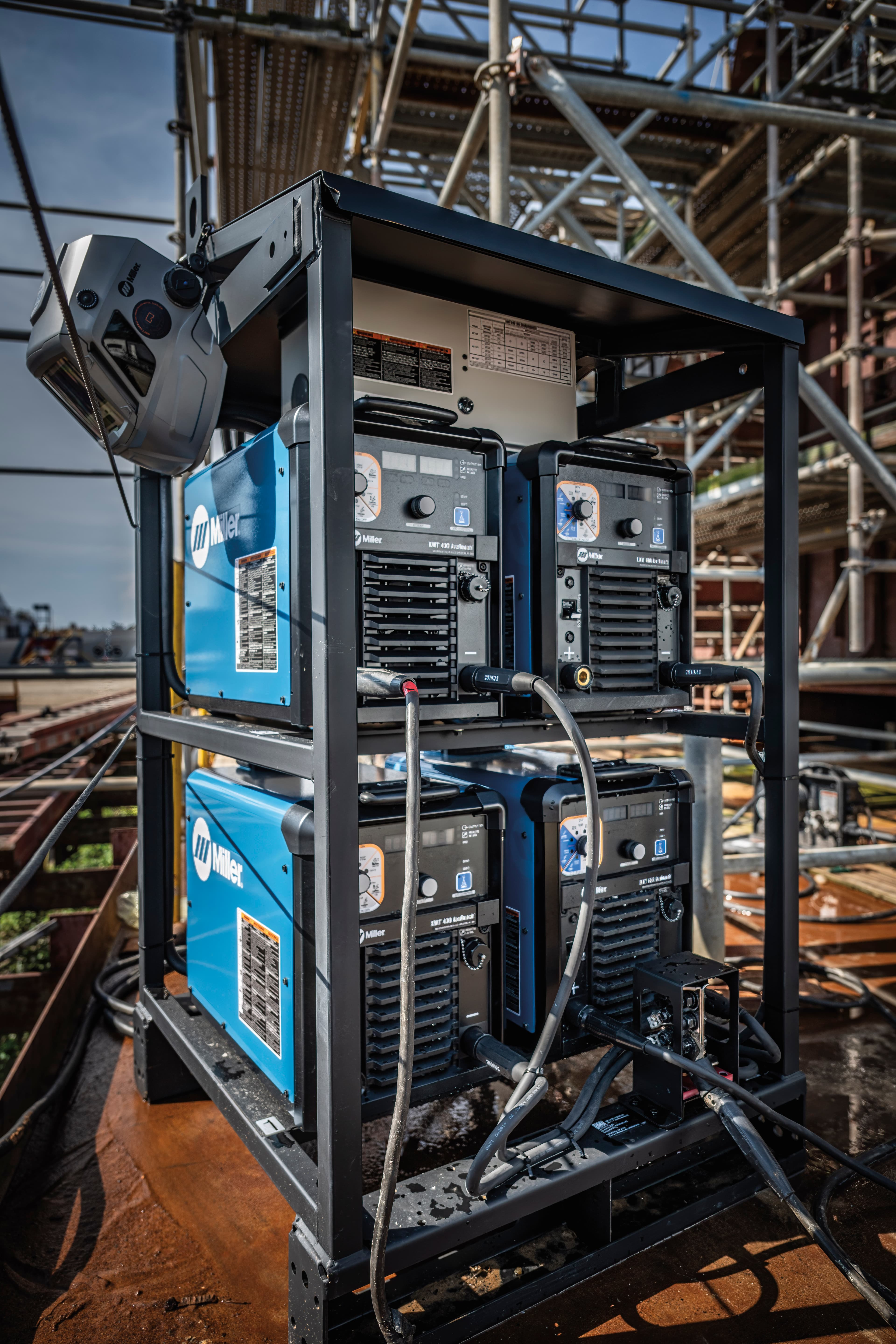

No matter if you rent or buy, when your operation needs large quantities of welders, running single inverter machines or inverter racks with an engine-driven welder/generator enables multiple operators to work from a single inverter rack or engine-driven welder — reducing costs and jobsite congestion. Using diesel engine-driven welders can help contractors standardize fuel for their jobsite.
Using racks of plug-in welding power sources is also beneficial on jobsites where work is confined to a smaller area. A four- or six-arc rack of inverter welding power sources using a single power cord from a generator or power outlet lowers installation costs — as well as jobsite noise — compared to using four or more individual engine-driven welders.
