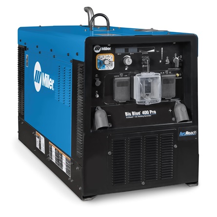

Designed with the professional in mind, the Big Blue 400 Pro is the best for ease of use, reliability and fuel economy.

Heavy-Duty Low-Speed Kubota V1505 Industrial Diesel Engine
Used in industrial applications around the world, the V1505 is designed to run 10,000 hours before major overhaul. Backed by worldwide support and service.
Dynamic DIG™
Unlike conventional DIG that provides a preset amount of short-clearing current, Miller’s proprietary Dynamic DIG works on a time-based algorithm that automatically adjusts the amount of current required to clear a short. What does this mean? A smoother more consistent arc that can be tailored to match application, material, fit-up, and welder technique.   Learn More

Low OCV Stick (VRD)
When activated, reduces the open-circuit voltage to 15 volts when the power source is not in use, increasing operator safety without compromising arc starts.
Other Standard Features
Output contactor control, automatic idle, thermal overload protection, and 120-volt engine block heater.
Auto Remote Sense™ (ARS)
Detects if a remote control is plugged into the 14-pin receptacle and eliminates confusion of a remote panel switch.

Amperage 20 A - 400 A
Weldable Metals Stainless Steel
Steel
Rated Carbon Diameter 3/16 in (4.8 mm)
Current Type DC
Max Open Circuit Voltage 85 VDC
Portability Lift Eye (Standard)
Trailer (Optional)
Cold Weather Starting Aids Engine Block Heater
Glow Plugs
Engine Brand Kubota®
Engine Compliance T4F
Engine Idle Speed 1500 RPM
Engine Weld Speed 1800 RPM
Fuel Tank Size 11.5 gal.
Fuel Type Diesel
Horsepower 20.2 hp
Weld Output CC/CV
Rated Output 400 A at 24 V, 100% Duty Cycle,350 A at 27 V, 100% Duty Cycle,300 A at 32 V, 100% Duty Cycle
Single Phase Auxiliary Continuous Power 10000 W
Single Phase Auxiliary Peak Power 12000 W
Sound Rating Idle: 66 dB, Weld: 71.6 dB
Compressed Air no
Net Width 26.25 in
Net Height 32 in
Net Length 56 in
Net Weight 950 lbs
Warranty 3 Years
