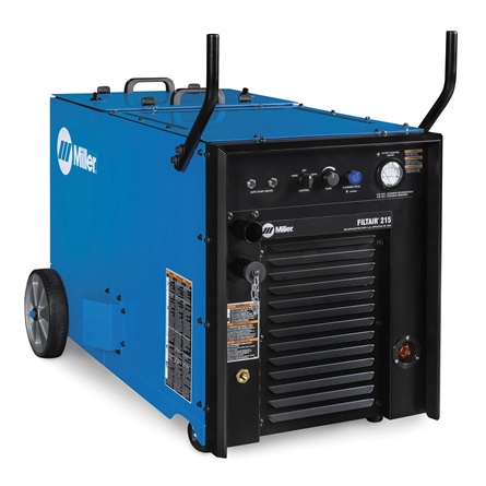

Self-Cleaning Filter
Includes a self-cleaning mechanism that releases a strong reverse pulse of air to remove the collected fume off the outside of the filter. The self-cleaning model requires less maintenance and a longer filter life.
MERV 15 Filter Rating
Large Rear Wheels
Allow for easy movement from one work area to another.
Filter Cleaning Gauge
Indicates when filter needs to be cleaned.
Variable Flow Control
Front-panel mounted air flow adjustment makes it easy to set the proper amount of extraction when using a funnel nozzle, slotted nozzle, or Bernard® fume extraction gun.
Bag-out filter change
Allows used filters to easily be removed from the fume extractor, keeping the particulate secure for a cleaner removal process.
Bernard® Clean Air™ Fume Extraction MIG Guns
Maintain a clean work environment by using multiple Bernard® Clean Air™ guns to extract fumes at the weld bead.   Learn More
Auto Start/Stop (optional)
Fume extractor remains off until the sensor detects torch activity, maximizing energy savings and extending filter life.
Particulate Disposal Bin
Provides easy and convenient access to empty out collected particulate. Handles release drawer allowing it to slide out.
Metal Cabinet Design

General Specifications
Title FILTAIR® 215 High-Vacuum Fume Extractor 208/230V
Nominal Airflow 215 CFM
Input Voltage 220/208 V
Input Phase 1-Phase
Input Hz 60 Hz
Input Amperage 30 A
Motor Horsepower 5.5
Filter Type Self-cleaning
Filter Media 75 ft²
Weld Fume Extractor Type High vacuum
Net Width 22 in
Net Height 30 in
Net Length 46 in
Net Weight 390 lbs
Warranty 1.97 Years
