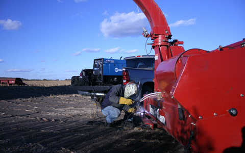

Projects may include rebuilding a trailer hitch, fixing a broken axle or spindle, repairing a broken fence line or adding rows to a corn planter for greater capacity and efficiency. For all of these tasks on the farm — and many more — a welder or an engine-driven welder/generator are important tools.

Farmers should also consider a portable engine-driven welder/generator solution that can provide more versatility for repairs in the field — away from the shop. Often wagons, tractors, combines and other farm equipment break down in the field or on the road, and they cannot be easily transported back to the shop for immediate repair. A portable welder/generator comes in handy in these situations, so repair and fabrication can be handled where it is needed.
A welder/generator can also help meet power generation needs in the field, running tools, lights and other items on the farm or in the field when you are away from a building with power.
The Bobcat™ 250 welder/generator provides multiprocess welding capability for stick, MIG, flux-cored and TIG welding, while at the same time providing 10,500 watts of power for lights or virtually any other tools needed in the field. The electronic fuel injection (EFI) option also provides fast, easy starts no matter the climate.
