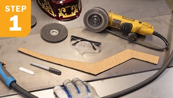

tools and materials for side table
STEP ONE:
First, draw the desired shape of the table legs on a piece of cardboard and cut it out. This will be used as your template for Step 2.

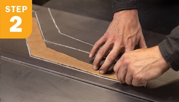

tracing template onto metal with chalk
STEP TWO:
Next, trace out your design on a 1/4" steel plate with a piece of chalk. Do this for all three legs.

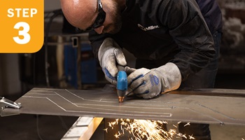

cutting out metal with a plasma cutter
STEP THREE:
Cut out each leg with a plasma cutter.

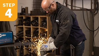

grinding metal with a grinding disk
STEP FOUR:
Once your legs are cut out, first use a grinding disk to clean the edges and remove any excess material, then use a sanding disk to soften the edges. If you want to give your table legs a hand-forged look, take a sanding disk and run it over the front and back of each leg.

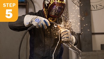

mig welding two metal table legs together
STEP FIVE:
Take two of your table legs and tack weld at the top. Next, add the third leg and tack weld it to the other two. Place tack welds on the bottom where the three pieces meet. Then, adjust the legs to ensure they are correctly placed and weld together.

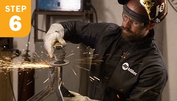

STEP SIX:
Grind down the tack welds on the top of the table base and smooth the bottom of each table leg with a sanding disk to ensure your table is level.

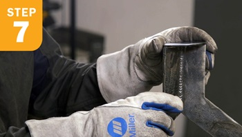

STEP SEVEN:
Optional: Tack weld a small disk onto the top of the table base for additional stability when mounting the table top.

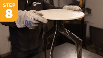

placing a marble table top onto metal table base
STEP EIGHT:
Apply a high-grade adhesive to the disk (or directly to the top of the base if you skipped Step 7) and mount the marble top to your table base.

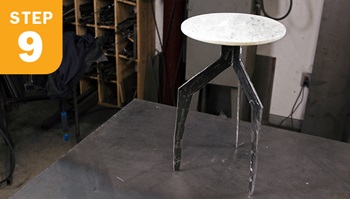

STEP NINE:
Optional: Add a sealant, finish or patina of your choosing to the table base — and your side table is ready to be used!
