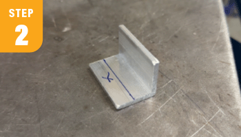

Next, mark 7/16-inch from the inside edge of the angle. This will be your guide for the next cut.
step 3

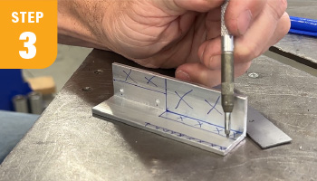

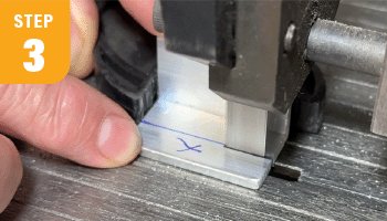

STEP THREE:
Carefully cut along the edge of the line so that the saved part maintains a width of 7/16-inch. Take your time to ensure accuracy.

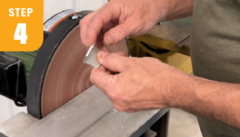

STEP FOUR:
Deburr the cut edges to remove any sharpness and ensure a smooth finish.

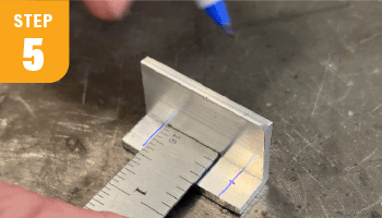

STEP FIVE:
On the short side of the angle, mark for holes that are 1-1/8 inches apart, 3/16-inch from the top edge and 1/4-inch from either side. These marks will guide your drilling.

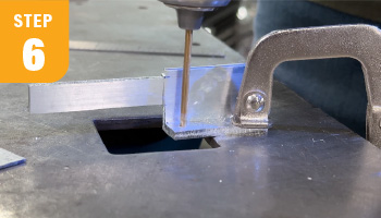

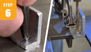

STEP SIX:
Use a center punch to create indentations at the marked points, then drill the holes using a #26 or 9/64" drill bit.

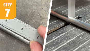

STEP SEVEN:
Cut a 3-5/8-inch piece of the 1/4-inch round stock. Ensure the cut is clean and straight.

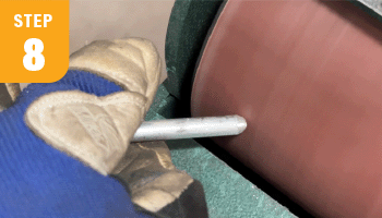

STEP EIGHT:
Form a radius on one end of the round stock. This will help in creating a smooth hook shape.

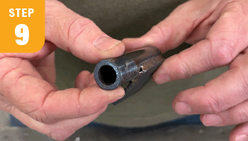

STEP NINE:
Find a 3/4-inch round piece of tubing or a bolt to use as a form for bending the hook. This will help achieve a consistent curve.

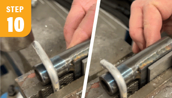

step 10
STEP TEN:
Hammer form the 1/4-inch tubing around the tubing. Start about 2-1/4 inches from the rounded end to create the desired hook shape.

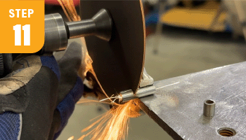

STEP ELEVEN:
Cut two pieces of the 6 mm OD x 4 mm ID x 20 mm long standoff spacers to a length of 7 mm or .275 inches. Ensure the cuts are precise.

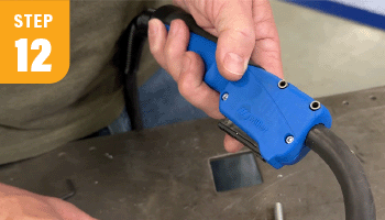

STEP TWELVE:
Remove the top two cap screws from the gun handle. Temporarily install the spacers and the mounting bracket using two 6-32 x 7/8-inch-long socket head cap screws.

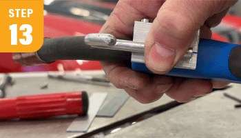

STEP THIRTEEN:
Determine where you want your hook welded. I centered mine on the gooseneck for balance.
step 14

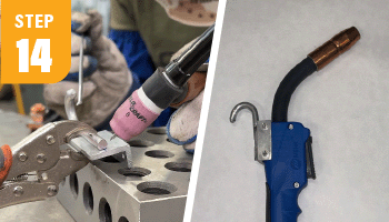

STEP FOURTEEN:
Remove the mount from the gun and grind a small flat spot on the bottom of the hook where it will mate to the gun mount. Clamp the hook in place and weld it securely.

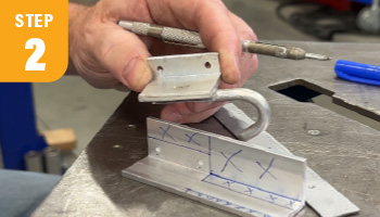

step 2
STEP TWO:
The base mounting dimensions will be the same as the round hook design. Follow the same measurements for consistency.

Note the additional 2-1/8-inch x 7/16-inch-wide flat strip. This will be used for the flat hook design.

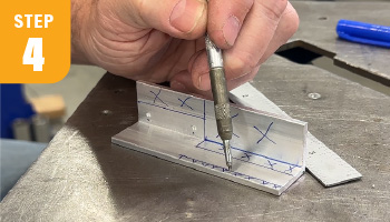

STEP FOUR:
Position the flat strip 1/8-inch from the top edge of the angle. Mark the additional cut areas with an “XX.”

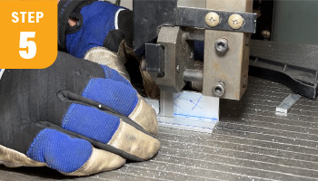

step 5
STEP FIVE:
Cut out all areas you marked with “XX” for drop-off. Ensure the cuts are clean and precise.

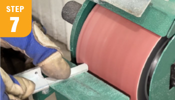

step 7
STEP SEVEN:
Grind a radius at the tip of the strip and deburr any cut edges to ensure a smooth finish.

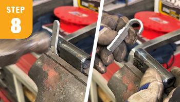

step 8
STEP EIGHT:
Bend the strip around the 3/4-inch round form, just as you did in step 10 of the round hook hanger instructions. Ensure the bend is smooth and even.
