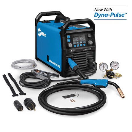

MIG and flux cored 120 / 240V welder that welds up to 3/8-inch steel and aluminum.
Compare
Machine Only
907839
Running Gear Cylinder Rack
951000073
Download the latest product update for your welder! View Available Updates! >>>
What's Included
  • Millermatic 211 PRO
  • 15 ft. (4.6 m) MDX™-100 MIG gun
  • 15 ft (4.6 m) Work cable with clamp
  • 6.5 ft (2 m) power cord and MVP™ adapter plugs for 120V and 240V
  • Argon and AR/CO2 mix regulator/flow gauge with hose
  • Quick Select™ drive roll for .024 in (0.6 mm) or .030/.035 in (0.8/0.9 mm) solid wire, and .030/.035 (0.8/0.9 mm) flux cored wire
  • Material thickness gauge #229895
  • Hook-and-loop cord wraps
  • Two contact tips for .035 in. (0.9 mm) wire
Dyna-Pulse™
BeadVision™
Auto-Set™ Technology
Upgradeable Software
Product upgrades are easy as downloading software updates to a USB stick and plugging it in.
Smooth-Start™
This technology provides a smooth, spatter-free start. No more pop-gun starts or spatter to clean up.
Angled Drive System with Quick Select™ Drive Roll
Makes setup quicker by offering three grooves - two for different size solid wire and a third for flux-cored wire.
Multi-voltage plug (MVP™)
Inverter Technology
Auto Spool Gun Detect™
Generator Compatible
Weld Longer
Program mode allows easy save and recall of favorite weld settings
Not Included
  • Shielding gas
  • Safety Equipment
  • Magnifying lenses
Processes
Flux Cored (FCAW)
MIG (GMAW)
Pulsed MIG (GMAW-P)
Technologies
Auto-Set
General Specifications
Title Millermatic® 211 PRO
Applications Automotive Welding
Car Restoration
Fabrication
Garage/Shop
Mobile Fabrication & MRO
Welding Projects
Industries Auto Repair
Construction & Fabrication
Manufacturing
Racing, Customizing & Restoring
Amperage 30 A - 230 A
Material Thickness Aluminum 18 ga. (1.2 mm) - 3/8 in. (9.5 mm)
Mild Steel 24 ga. (0.5 mm) - 3/8 in. (9.5 mm)
Weldable Metals Aluminum
Stainless Steel
Steel
Current Type DC
Rated Output 120V: 110 A at 19.5 VDC, 60% duty cycle 240V: 160 A at 22.0 VDC, 60% duty cycle
Max Open Circuit Voltage 57 VDC
Wire Feed Speed 1.5 m/min - 15.2 m/min
60 IPM - 600 IPM
Wire Diameter Stainless 0.024 in. - 0.035 in.
Stainless 0.6 mm. - 0.9 mm.
Solid Steel 0.6 mm. - 0.9 mm.
Solid Steel 0.024 in. - 0.035 in.
Flux Cored 0.03 in. - 0.035 in.
Flux Cored 0.8 mm. - 0.9 mm.
Spool Size 4-inch or 8-inch (102 mm or 203 mm)
Portability Handle(s)
Running Gear / Cart (Optional)
Weld Output CV
Input Voltage 120/240 V
Input Phase 1-Phase
Net Width 9.75 in
Net Height 14.625 in
Net Length 20 in
Net Weight 35 lbs
Warranty 3 Years
Miller's True Blue Warranty
