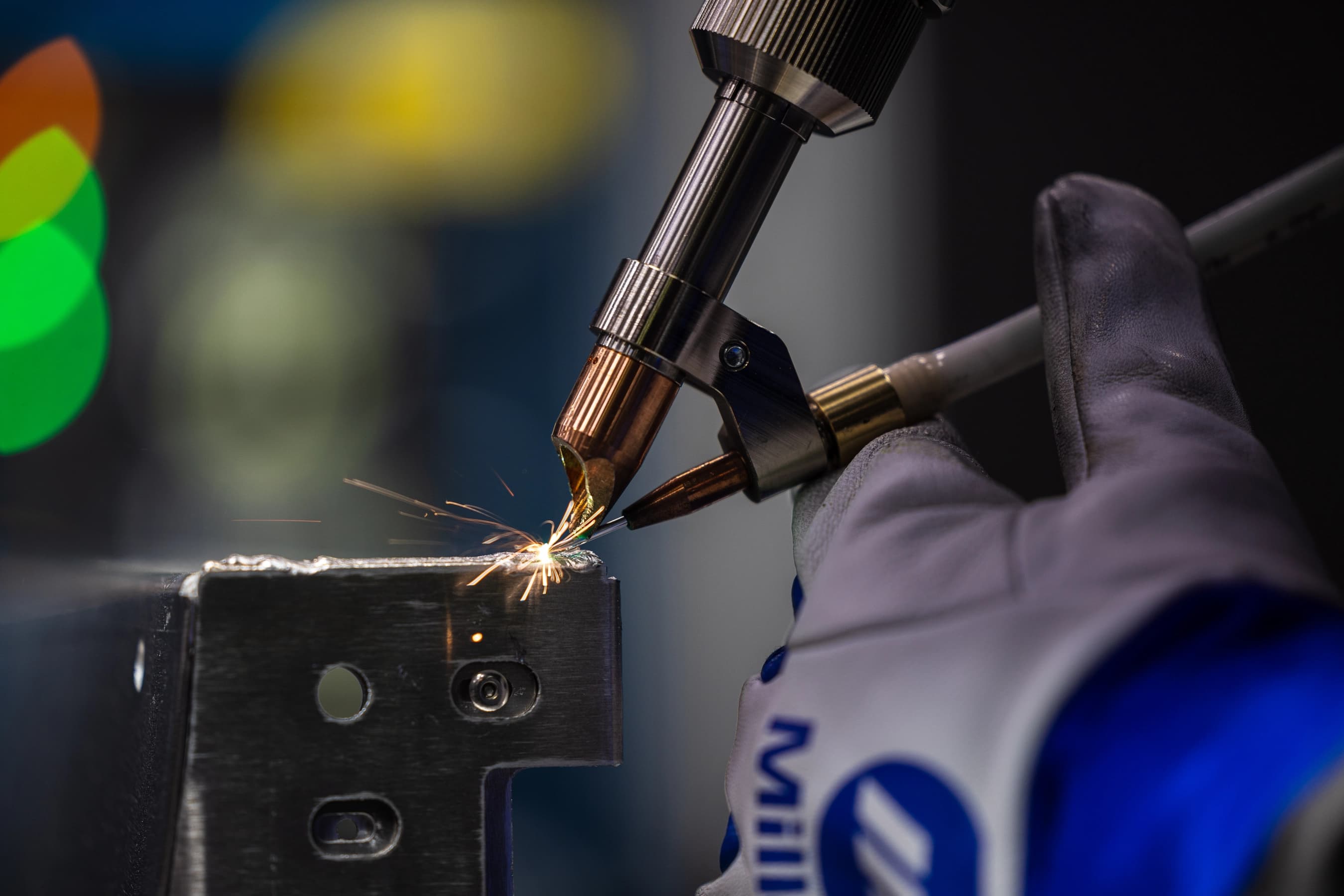

Heat management is the foundation of weld quality, especially on thin materials. Handheld laser welding delivers energy in a tightly focused spot, allowing the joint to reach welding temperature quickly while limiting how much surrounding metal heats up. This concentrated heat profile keeps distortion to a minimum and produces a narrow heat‑affected zone. On 18‑gauge carbon steel, laser welding introduces roughly 50% of the total heat that TIG or MIG would put into the same part.
With stainless steel, laser welding’s limited heat input helps preserve the corrosion‑resistant chromium oxide layer adjacent to the weld, reducing discoloration and backside sugaring when penetration depth is properly controlled. The small, controlled melt pool also means there is no arc‑related spatter, resulting in a smooth bead with minimal post‑weld cleanup.

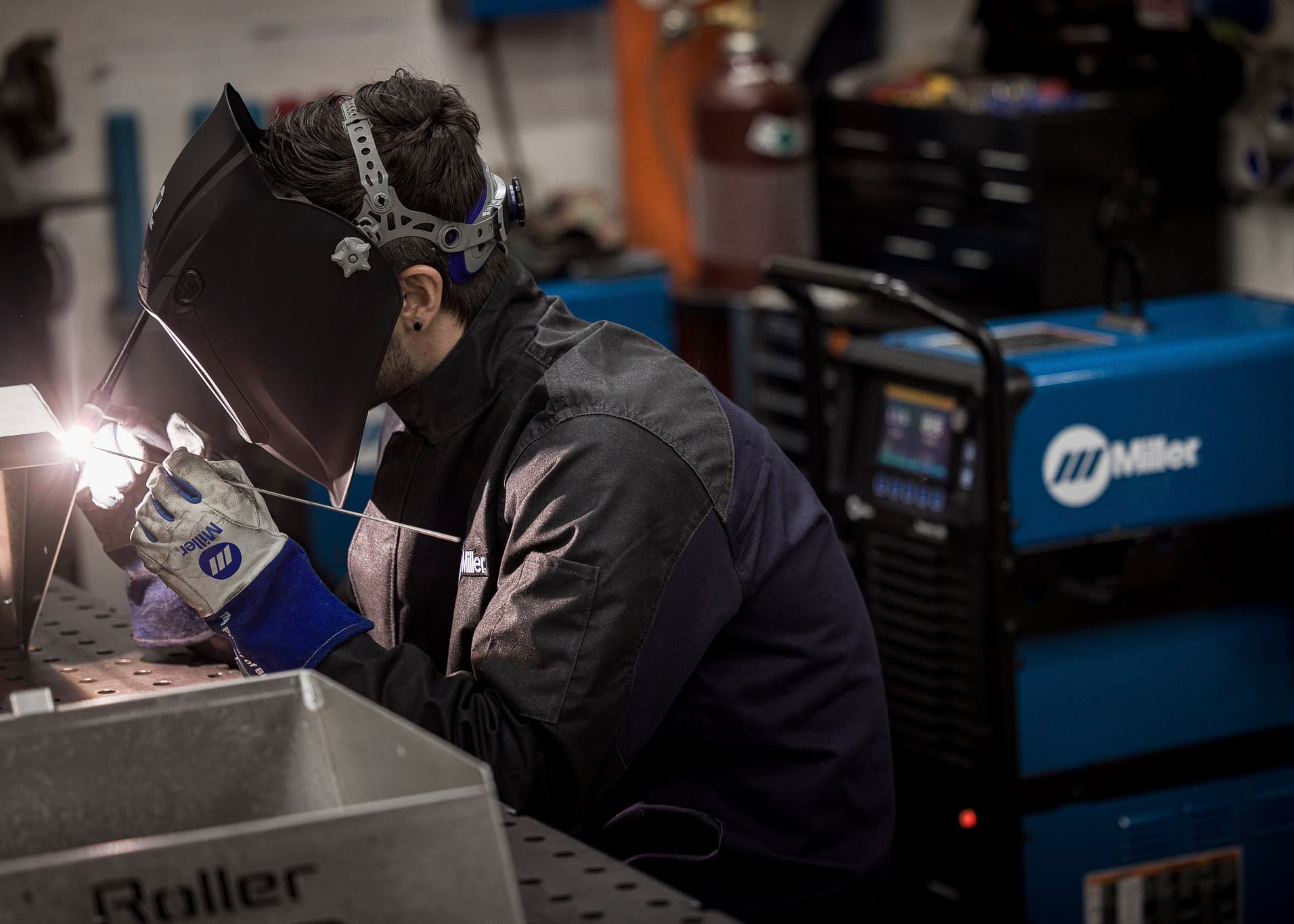

By comparison, TIG welding applies heat more gradually and across a wider area. The slower travel speed keeps the base metal hot longer, which often leads to more warping on light‑gauge sections and a broader band of heat tint around the weld. MIG welding moves faster than TIG and introduces less total heat overall, but its arc still covers a larger area than a laser’s focused beam. On thin stainless sheet metal, MIG welds typically show some distortion and visible oxide tint that must be polished off, along with spatter from the continuous wire feed.
