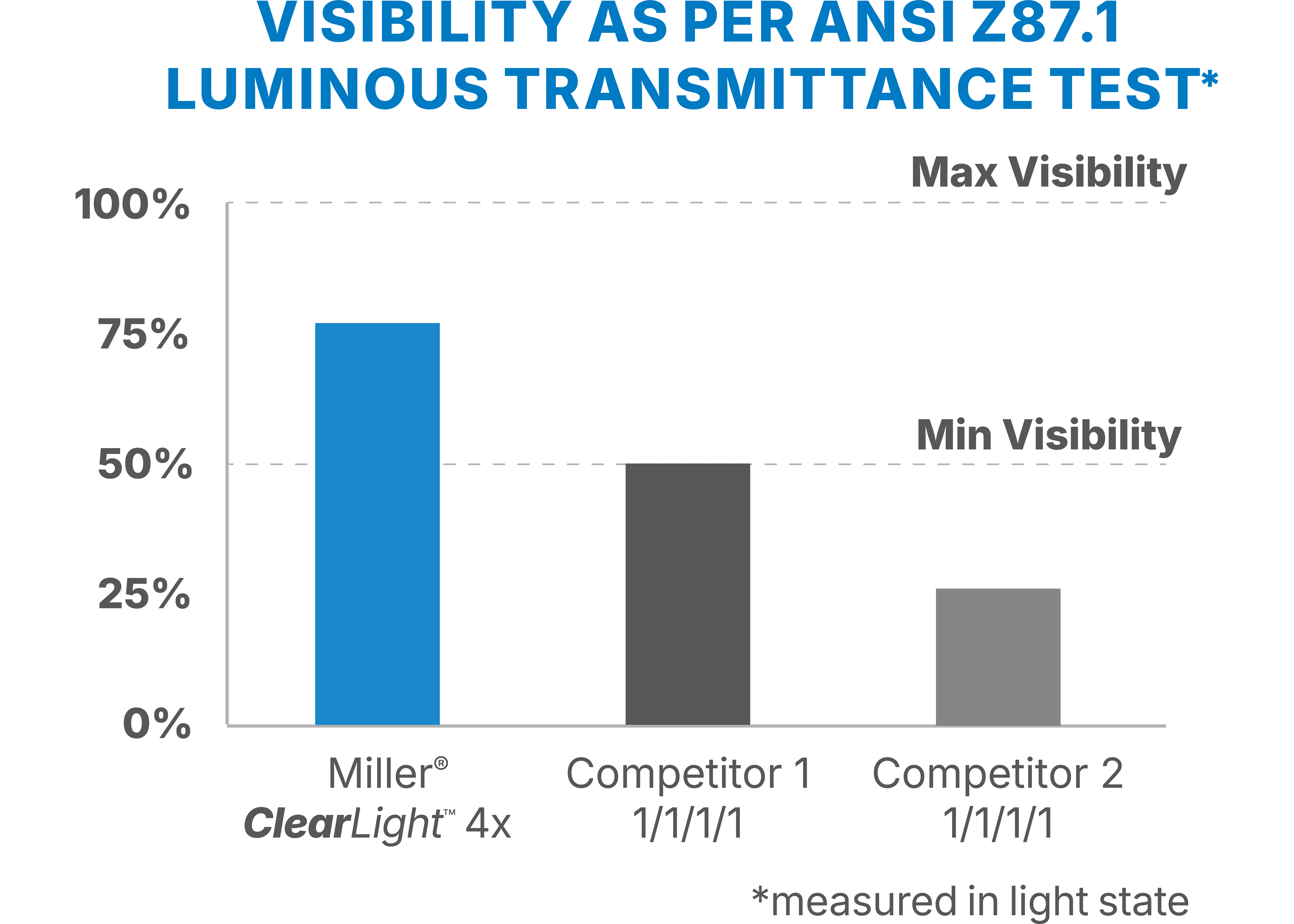

ClearLight 4x Chart Visibility V2

In a perfect world, a welding lens would achieve the highest clarity ratings in both U.S. & EN standards. In practice, if you target perfect EN optical clarity with the fourth rating (1/1/1/1), you sacrifice up to 50% reduced visibility as benchmarked by ANSI light tests. This means manufacturers and welders must currently choose between the two standards and cannot meet the highest optical clarity benchmarks in both.
Since visibility is a priority for all welders, it is clear why experts in the U.S. do not require the EN optical rating and why 1/1/1/1 is not the best visibility rating. A welding helmet with EN 1/1/1/2 rating can have 4x better clarity benchmarked under Z87.1 compared to leading 1/1/1/1-rated helmets. There is no need to sacrifice up to 50% of your visibility when technology innovation provides it all with ClearLight® 4x Lens Technology.

There’s a lot more we could say about the benefits of ClearLight 4x, but the main thing to remember is this: ClearLight 4x provides up to 4x more clarity when compared to welding helmets with 1/1/1/1 per the official USA ANSI certification of lens visibility.
