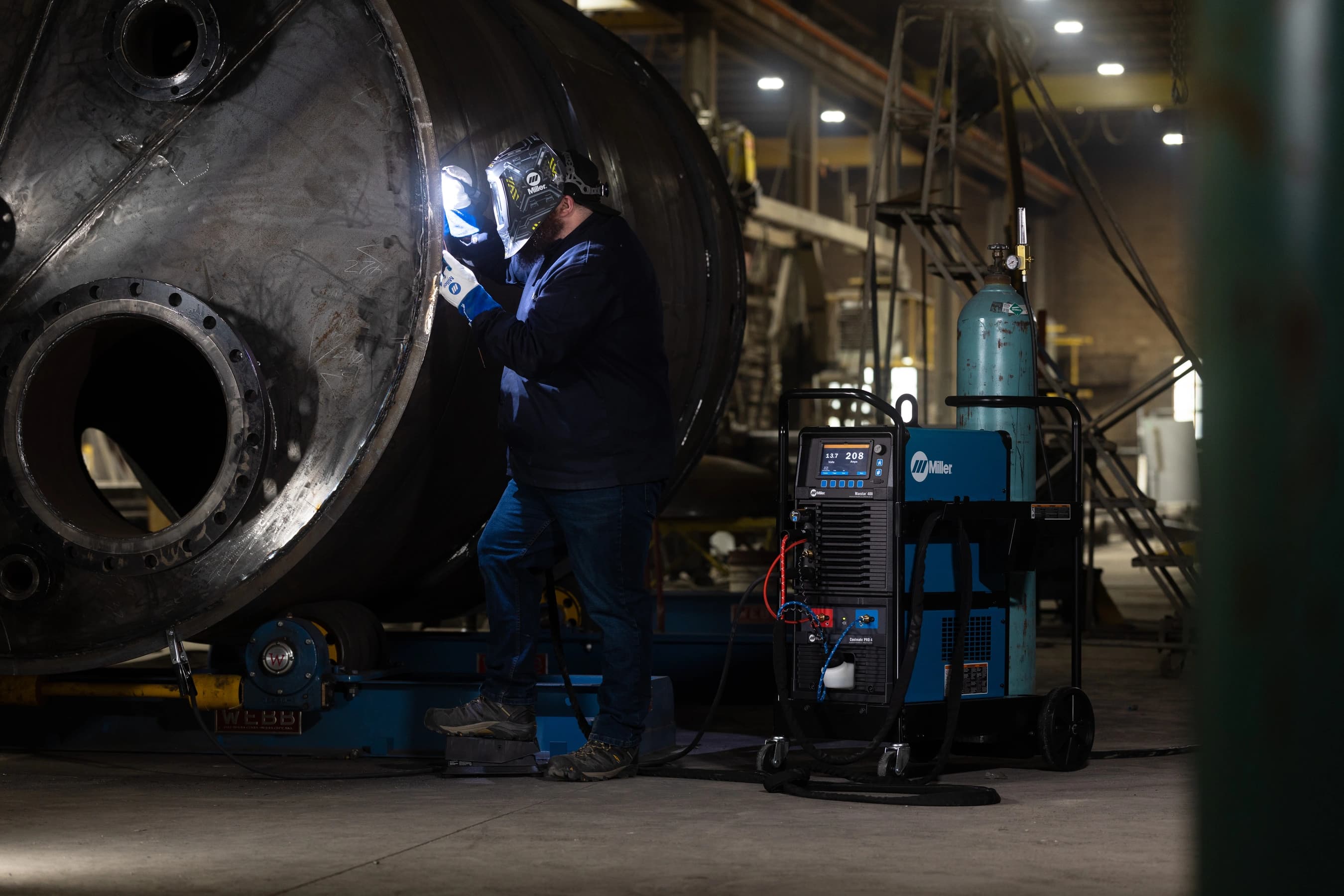

Maxstar 400 Application 117A2637

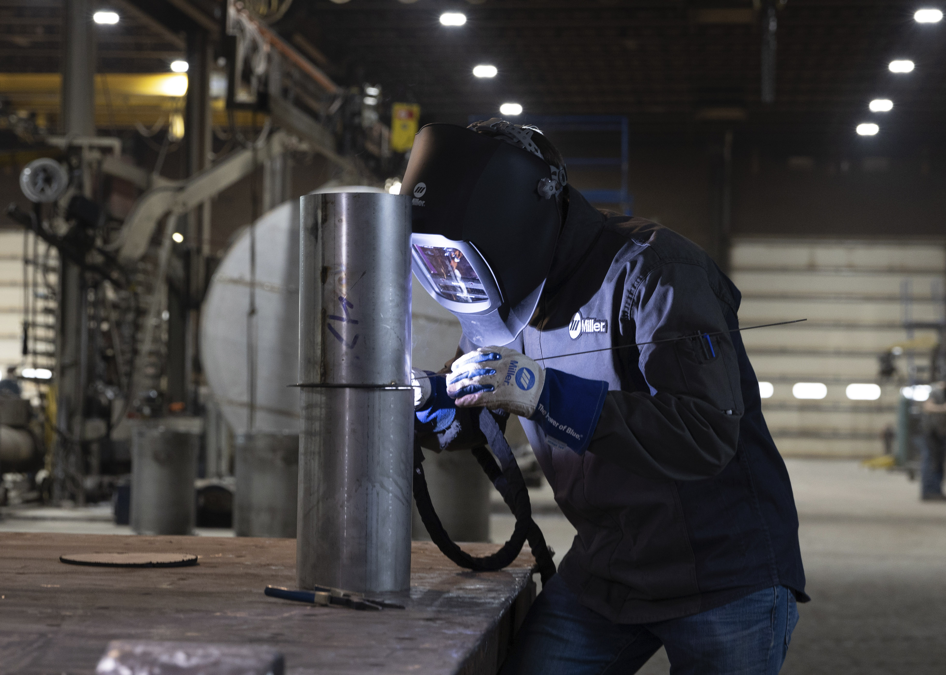

Maxstar 161 Application_DNA3241
