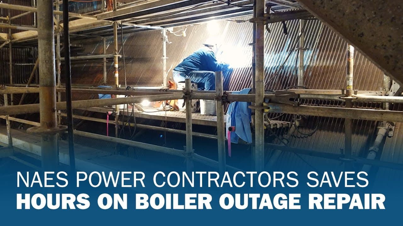

Depending on the size and scope of the boiler, the work can be difficult to reach. The boilers may be 400 megawatts or 900 megawatts, but the work completed inside is often similar. Welders may have to climb into the boiler through a 24-by-24-inch hole. Once inside, they may climb through additional crawl spaces or up scaffolding to reach the pipes to be repaired.
The welding may involve lying on their backs or at a sloped angle to complete an overhead weld. Despite the difficult positions and small spaces, the welds must meet high quality standards and are often subject to X-ray, radiographic or hydrostatic testing.

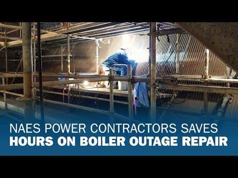

There may be 100 welders or more inside the boiler during a job, and they could all be running the same type of welding power source. This can result in a tangle of welding leads, making it hard for operators to determine which lead and machine is theirs when they want to switch polarity or make parameter changes. Going from the TIG root pass to the stick passes requires the welders to trace the lead, find their machine — which often is outside of the boiler — and switch the cables to go from straight polarity (TIG) to reverse polarity (stick). This process could happen up to a dozen times per day per welder.
“Their leads end up being like a weave of spaghetti going up through the scaffold,” Cessna says. “It could take anywhere from a half hour to an hour to trace his leads up, get the machine switched over and climb back in.”
This process also increases slip, trip and fall hazards for welders climbing in and out of the boiler.
In this situation, it’s also not uncommon for a welder to accidentally change parameters on the wrong machine. This results in frustrated welders and the potential for blown welds or porosity if the operator begins welding in the wrong polarity or with incorrect parameters.
“Sometimes we have people employed full time, and their job is tracing leads all day,” Dudo says. “That just takes a lot of time.”

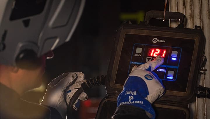

NAES Power Contractors eliminated these wasted hours with the XMT 350 FieldPro with Polarity Reversing welding system. The machine allows NAES welders to simply push a button on the Stick/TIG Remote to switch processes and polarity. Operators don’t need to leave the spot where they’re working or switch leads at the power source.
The productivity gains were immediate for NAES welders. Operators using the system completed 10 to 14 welds per shift, compared to the four to five welds completed per shift by welders not using the system.
“It was phenomenal,” says Jesse Yourich, a welder with Boilermakers Local 154 in Pittsburgh. “You do everything right there. It definitely saves a lot of time, and it just makes life a lot simpler.”
NAES also saved time in cable setup and management, since there are fewer welding leads needed inside the boiler.
The system also prevents any changes from being made at the power source once the Stick/TIG Remote is connected. This eliminates the chance of another welder accidentally adjusting parameters or changing processes on the wrong machine.
“It takes away frustration from guys if they’re in the wrong polarity,” says Chris Darnell, NAES project manager. “[The technology] takes away the repairs to be made on the tube work. It saves time and money.”

NAES welders can also adjust parameters without stopping the arc because the system has Adjust While Welding (AWW™) technology. This capability is especially handy because the company does a lot of “brother-in-law” welding, where two operators weld around the same pipe, trading off the arc on the same stick welding pass.
Because welders don’t have to leave the boiler to make changes, it reduces the risk of slips, trips and falls.
“Staying in your work area, being able to switch the machine, you’re not crawling up and down ladders, in and out of holes,” Yourich says. “It’s just all-around safer.”
