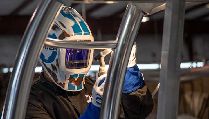

Bright dip anodizing adds a special coating that enhances the glossy appearance of aluminum for cosmetic applications, resulting in a very reflective surface. To avoid scratching or damaging BDA aluminum during welding, operators often change their technique slightly to ensure the cups are farther off of the material surface.
“Welding anodized aluminum is a little bit more difficult,” Holl says. “It has to stay bright, with perfect finish and polish.”
If the welder “arcs out” or flares up it can cause spatter, which can leave marks on the surface of the BDA material. Any scratches or blemishes mean that leg must be cut out and replaced — without damaging other sections of the part. This rework process could take several hours and cost hundreds of dollars each time.

The welders previously used by G.G. Schmitt were transformer-based machines that tended to flare up, which meant a lot of rework on BDA aluminum.
The inverter-based Dynasty 400 TIG welder uses Blue Lightning™ high frequency arc starter technology and refined arc starting routine, which deliver more consistent non-contact starts and greater reliability compared to traditional equipment.
“Miller is by far the best to weld anodized aluminum,” says Pedro Medina, G.G. Schmitt assistant plant manager. “You don’t take the chances to ruin a part.”
The switch immediately reduced scrap rework by 6 to 8 percent for G.G. Schmitt — a payback that continues to increase as the welders become more familiar with the Dynasty 400 machines. The company is starting to see 10 to 11 percent less scrappage of the BDA aluminum associated with tungsten spitting and flare-ups.
The machines also include independent amplitude/amperage control, so electrode positive and electrode negative amperages can be set independently. This allows G.G. Schmitt welders to precisely control heat input to the work and electrode. In addition, extended AC balance controls the amount of oxide cleaning (amperage time in electrode negative), which is essential for high-quality welds on aluminum.
“You’re always going to get the best results,” Medina says. “Your weld is going to look good.”
