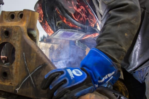

The demand for fast turnaround in equipment maintenance and repair — along with the outdoor site conditions — means Schnabel’s crew does a lot of stick welding. But they also perform flux-Cored welding using Miller SuitCase® X-TREME™ VS wire feeders for larger projects.
Their day might include welding steel hydraulic lines, welding 1-inch steel plate, fabricating custom parts for the wash plant or carbon arc gouging cracks in an excavator bucket.

Schnabel’s team gets the job done while wearing Arc Armor® protective gear from Miller, including welding jackets, gloves and helmets.
Blaschke has a Digital Elite™ Series helmet that offers a lighter weight, to help reduce neck strain. The crew also uses Titanium Series™ 9400i helmets, which feature a flip-up grinding shield.
“It’s one helmet for dual needs, and you can flip it up so quick and see what you’re doing and then flip it right back down and get back to welding,” Blaschke says.
