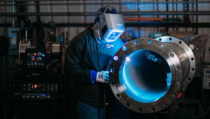

For welding stainless steel pipe, Dixie Mechanical followed the traditional process of using a TIG root pass with an argon back purge followed by flux-cored fill and cap passes.
The back purge on stainless steel was an especially time-consuming process, typically requiring 20 to 30 minutes depending on the pipe size to set up the argon shielding gas and tape the pipe ends for purging. In addition, the argon gas used for back purging added to consumable costs.
Another productivity killer: Swapping leads and polarities when they changed from TIG welding for the root pass to flux-cored welding for the remaining passes.
“It is just time wasted, really,” Howell says.
After: Eliminating back purge with a multiprocess welding solution
In looking for efficiency improvements, Dixie Mechanical worked with their local welding supply distributor to test several welding power sources from different manufacturers. They knew it was important to get buy-in from the welders who would use the machines.
"The welders chose the Miller, hands down," Howell says.

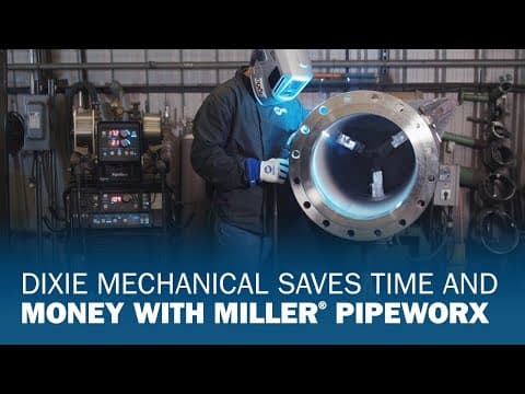

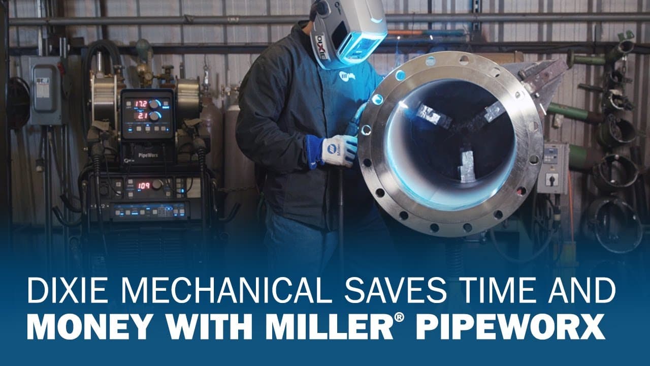

The clear favorite was the PipeWorx 400, a multiprocess system that offers capabilities for MIG, TIG, stick and flux-cored welding as well as the Regulated Metal Deposition (RMD®) process, a modified short-circuit MIG process from Miller.
With PipeWorx, Dixie Mechanical switched from a TIG root pass to an RMD root pass with high silicon wire from Hobart — allowing them to eliminate the time consuming and costly back purge when welding stainless steel pipe. RMD uses precisely controlled metal transfer to provide uniform droplet deposition, which makes it easier for the welder to control the weld puddle. Controlled metal transfer and faster puddle freezing mean a less turbulent puddle and that the shielding gas exits the MIG gun relatively undisturbed. This allows the shielding gas to push through the open root, displacing the atmosphere and preventing sugaring or oxidation on the back side of the weld. Such gas coverage is only needed for a short time since the puddle freezes so quickly; eliminating the need for a back purge.
Some customers were initially wary of changing from the traditional TIG process they were familiar with, but the productivity and quality results with RMD helped Dixie Mechanical change minds. The company sends customers coupon samples and test results of welds made with the RMD process that show quality just as high as what is produced with TIG welding.
“It’s just so much faster,” Howell says. “It pays dividends when the welder can stay under that hood. It allows us to do more work.”
Doubling welding productivity
Eliminating the back purge when welding stainless steel pipe was one major time saver for Dixie Mechanical. Where the back purge could take 20 to 30 minutes per pipe, welders could be set up for the RMD root pass in about five minutes or less.
In addition, the wire-fed RMD process is much more productive than TIG welding, allowing operators to complete more welds in the same amount of time. For an 18-inch pipe, the TIG root pass and back purge followed by flux-cored fill and cap passes often took a few hours. The RMD root pass with no back purge followed by a flux-cored cap pass takes about 30 minutes.
“On average with TIG, I was doing 10 welds, and I can get 20 with RMD. It’s definitely double,” says Joey Sullivan, Dixie Mechanical welder. “The quality is just as good, if not better, and the speed is a lot faster. Pretty impressive.”
