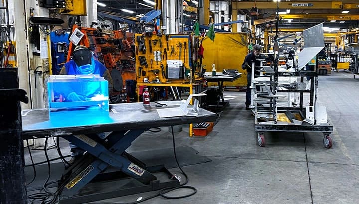

Due to the level of customization, Henderson doesn’t have many high-volume orders. This requires flexibility on the part of their welders and welding equipment.
“A lot of times when you look up and down our product lines, you see that everything is different,” says Welding Engineer Thomas Kenny. “Our machines and our welders have to be able to accommodate whatever material is thrown at them, whatever material thickness.”
The versatile machine that Henderson relies on to tackle any job? The Deltaweld® system and Intellx™ wire feeders. The system works on a wide range of materials and thicknesses while reducing post-weld cleanup and training time.
Henderson completes fabrication, welding, painting and final assembly at the plant, but welding is a core competency. It’s important that the nearly 80 welders at the facility are producing the same high-quality parts. Normal manufacturing cycle time is a week to 10 days, and the parts are typically mild steel or stainless, ranging from 16 gauge to several inches.
