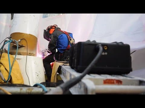

Utilizing wire welding processes and ArcReach remote control welding technology from Miller Electric Mfg. LLC allows Apex to address numerous challenges — helping to significantly improve productivity while meeting high-quality requirements and improving operator safety on the jobsite.
“The quicker you get jobs done — in an efficient manner, in a safe manner — you’re going to get more jobs and bigger jobs,” says Travis Slovernick, Apex field superintendent. “It’s just night and day, the difference with this (ArcReach) system.”
In addition to significantly improving productivity, remote control capabilities at the weld joint also provide benefits for worker safety. The fewer trips an operator must make back and forth to the power source — often up or down ladders or several flights of stairs — the fewer opportunities there are for slips, trips and falls and exposure to other jobsite hazards.
“We get in spots where it can be hard to get to sometimes, and when you do get there, the last thing you want to do is move again just to go up a volt or drop your amps,” says Kyle DePaoli, an ironworker from Local 86. “Not having to get off the iron every two minutes saves a lot of time, and it’s safer.”
It can also be an issue of operator fatigue, when an operator must climb up and down stairs frequently or get to and from a hard-to-reach welding location. One Apex job in Bellevue, Washington, involved constructing a sky bridge pedestrian walkway between two buildings. Operators used ladders laid flat to reach the weld, where they were joining two columns about 20 feet off the ground. Getting to the ground required maneuvering from that spot and going down several flights of stairs.
“The wear and tear on the guys and the fatigue — the remote technology saves everybody all the way around,” Slovernick says.
The ability to adjust parameters at the weld also eliminates operators to “making do” with less-than-optimal settings.
“Otherwise you might just say ‘that’s good enough,’” DePaoli says. “This way you’ll probably have your parameters where they should be.”
This helps ensure that Apex is meeting D1.8 structural welding code requirements and producing high-quality welds.
In addition, pairing an ArcReach wire feeder with an ArcReach power source locks out any changes to the weld process, voltage or amperage at the power source — only the welding operator can make changes at the feeder. This prevents accidental changes and eliminates mistakes that can occur if parameters are incorrectly changed.
“You’re sure that nobody can mess with your settings,” DePaoli says.
