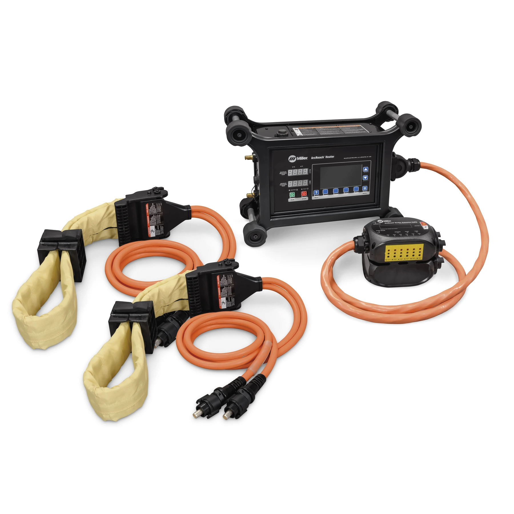

Precise, fast response control for induction cable preheat and rapid wrapping.
951849
Compatible for select ArcReach welding power sources. Use existing on-site welding equipment up to 200 feet away as the heating power source. ArcReach technology increases jobsite productivity and efficiency by eliminating the time spent to walking back to make adjustments.
Ideal for preheat and bake-out applications on pipe, plate, or odd geometries. Induction heating provides a fast time to temperature, consistent quality and even heat zone controlled throughout the part.
Automatically and accurately documents joint temperature every time a heating cycle is completed. Export data and create temperature charts with ArcReach Heater Data Application.
Enables welders to use the same equipment used for welding. Utilizes standard weld cables to power the ArcReach Heater and eliminates the requirement for expensive power drops.
Air-Cooled Cables (available in 30 ft, 50 ft, or 80 ft lengths) are flexible to be used on pipe, plate or odd geometries. Air-Cooled Quick Wrap is a simple tool for pipe applications 10 inches OD and below.
Welders will find the system intuitive to set up, use and tear down the system without having to wait for the tools to cool down. Heating profiles can be manually entered or loaded via USB drive using the Data Application.
The ArcReach Heater System eliminates the costly overruns common with heating contractors and allows contractors to regain control of heating costs and timelines.
Eliminates safety concerns caused by traditional open-flame heating and resistance heating.
