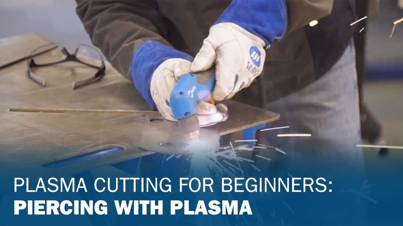

Plasma Cutting for Beginners: Piercing With Plasma
When piercing the metal at the beginning of a cut, start in an area outside of the design and hold the torch at an angle, as shown here. Push the trigger and roll the gun until it’s perpendicular to the metal. Then move to the side of the template and begin cutting.
