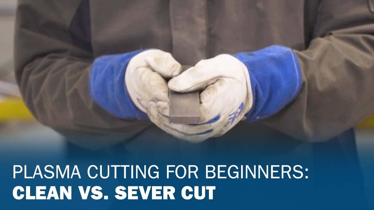

Tip #1: Choose the right plasma cutter
Some of the key factors to keep in mind when selecting a plasma cutter are output power, cutting speed, input power, duty cycle, and weight and size. Think about the jobs you will do most often when selecting your machine.
Output power: The necessary output power depends primarily on the thickness and type of material to be cut. Miller uses two standards: rated and sever cuts. A rated cut is the thickness of mild metal that an operator can manually cut at a rate of 15 inches per minute (IPM). A sever cut is the maximum thickness a plasma cutter can handle. The travel speed is slower, and the cut may require clean up.
Cutting speed: This is usually noted as inches per minute (IPM). A machine that cuts 1/2-inch material may take five minutes to do so, whereas another machine may take one. Cutting speed makes a significant difference in production time.
Input power: Will you always be using the plasma cutter in the same location, or do you need portability and the ability to use a variety of power sources? Look for plasma cutters that offer a range of power options. Some have the ability to switch from 120 volt to 240-volt power.
Duty cycle: Duty cycle is the amount of time a machine can cut within a 10-minute cycle without overheating. If a machine's duty cycle is 60%, the machine can run continuously for six out of every 10 minutes and then needs to cool for the remaining four minutes. A larger duty cycle is important when making long cuts, in high productivity applications or when using the machine in a hot environment.
Weight and size: If you need portability, many hand-portable units are available that weigh less than 45 pounds. The Miller® Spectrum® 375 X-TREME™ provides the ultimate in portability, weighing only 19 pounds.
Plasma Cutting for Beginners: Clean vs. Sever Cut

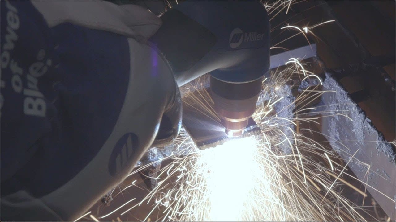

Tip #5: Use proper technique
Use your non-cutting hand as a support for your other hand. This steadies your cutting hand, provides freedom of movement in all directions and helps maintain a constant 1/16-inch to 1/8-inch standoff. Note that most people find it easier to pull a torch toward their body rather than push it away.
Holding a 1/16-inch to 1/8-inch standoff increases the cutting capacity of smaller machines and extends the consumables life.
Use a drag shield if your machine is equipped with one. This allows you to rest the torch on the workpiece while maintaining an optimal standoff without touching the tip to the metal, which will adversely affect cut quality and consumable life.
Begin cutting by placing the torch as close as possible to the edge of the base metal. Press the trigger to initiate the preflow air; the pilot arc will light, followed by the cutting arc. Once the cutting arc starts, move the torch slowly across the metal. Adjust your speed so that the cutting sparks emerge from the bottom of the metal. At the end of a cut, angle the torch slightly toward the end of the cut or pause briefly to completely finish the cut. The post flow air will continue for a short period after the trigger is released to cool the torch and consumable parts.

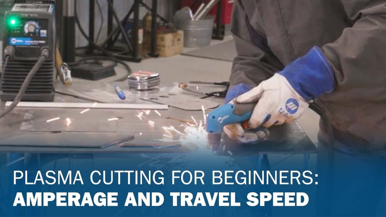

Tip #7: Watch the travel speed
The faster your travel speed (especially on aluminum), the cleaner your cut will be. When cutting thicker material, set the machine to full output and vary your travel speed. On thinner material, turn down the amperage and change to a lower-amperage tip to maintain a narrow kerf.
With a proper travel speed, the arc should exit the material at a 15- to 20-degree angle opposite the direction of travel. If it’s going straight down, it means you’re moving too slowly. If it sprays back, it means you’re moving too fast.
Traveling at the right speed and using the right amount of heat will produce a very clean cut with less dross on the bottom of the cut, as well as little or no distortion to the metal.
Plasma Cutting for Beginners: Amperage and Travel Speed
