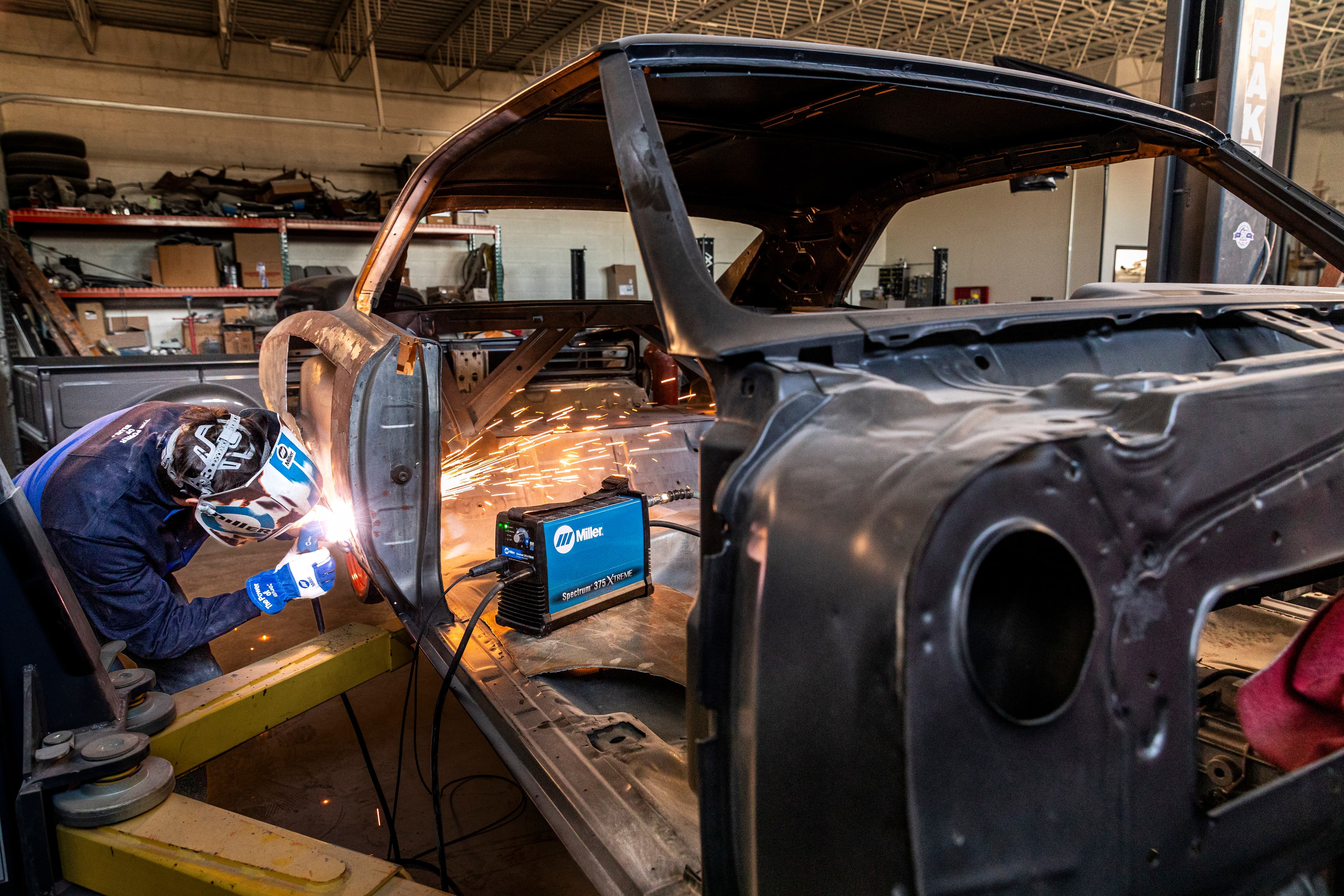

Most every custom car fabrication or repair involves cutting metal, and that starts with a plasma arc cutter. Whether you’re cutting sheet metal for body panels or thicker stock for steel frames, a plasma cutter is an essential tool for your custom build.
Plasma cutters offer flexibility to cut most types of metal in varying thicknesses, including steel, stainless, aluminum, copper, bronze, brass, titanium, Inconel and other materials. The process is also faster and easier than many other cutting methods. It delivers clean, precise cuts with a smaller heat-affected zone to help prevent material warpage or paint damage. Many plasma cutters are also lightweight and portable.
These tips can help you select the right plasma cutter — and get the most out of your machine.

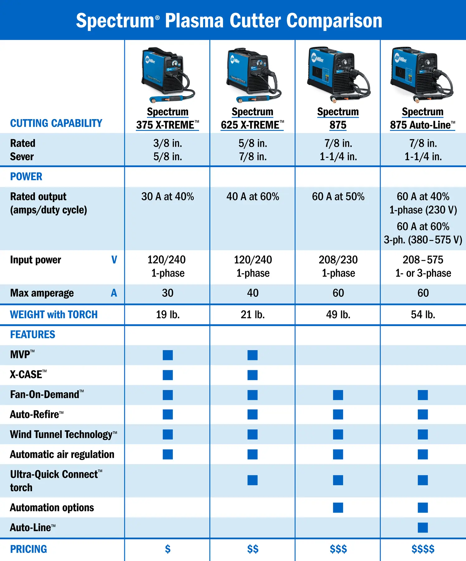

Plasma cutting can be performed on metals of varying sizes, from thin-gauge aluminum to stainless and carbon steel up to several inches thick. The output power needed depends primarily on the thickness and type of material to be cut. The metal thickness also determines the size of the nozzle opening and the type and amount of gas or air required. Determine the type of metal you plan to cut and then check the cutting capacity of the machine.
Miller uses three standards to denote a machine’s cutting capacity: rated, quality and sever cuts. A rated cut is the thickness of mild metal that an operator can manually cut at a rate of 10 inches per minute (IPM). A quality cut is rated at a slower speed but on thicker metal. A sever cut is the maximum thickness a machine can handle. The travel speed is slower, and the cut may require clean up.
The Miller® Spectrum® 375 X-TREME™ has a cut rating of 3/8 inch and a sever rating of 5/8 inch. This type of machine works well for most automotive fabrication and repair. A more powerful machine may be necessary if you plan to cut thicker materials.
