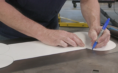

Once you’ve developed your design, either by hand or using a graphics program, the first step is to transfer it to your metal workpiece. There are various methods of accomplishing this, including tracing a cardboard cutout or using carbon paper to transfer a sketch and then retracing it with a black marker so it can easily be seen while cutting. Carbon paper is available in many art supply stores.

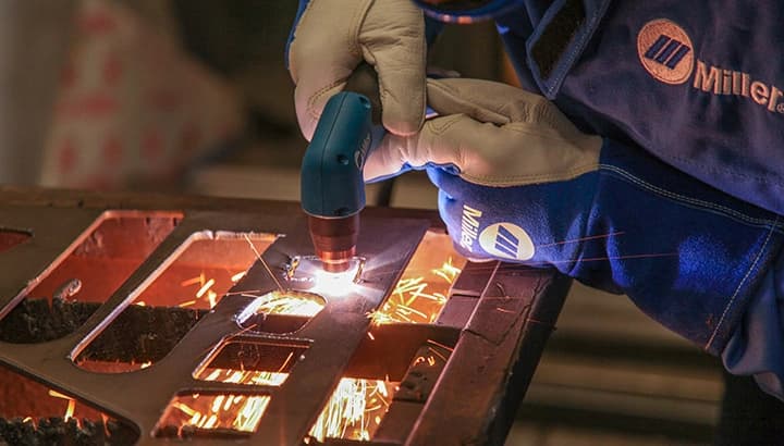

You should choose a plasma cutter that cuts the thickness of metal you will work with most often. There is an exception, however. If you will begin most of your cuts by piercing the metal, as opposed to starting from an outside edge, a good rule of thumb is to use a machine capable of cutting twice the thickness you are cutting. It’s important to be able to pierce the material quickly; otherwise molten material can splash back into the torch tip and shorten tip life.

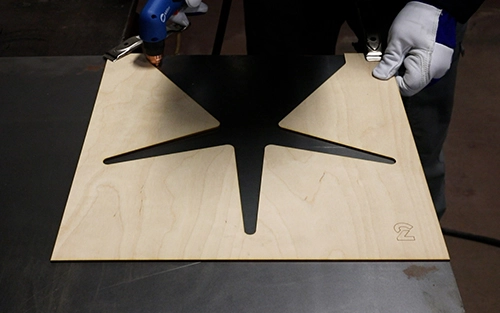

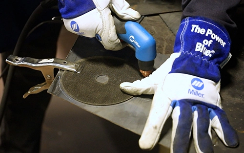

If you’re designing a piece to be used as a template, you need to account for the radius of the cutting tip or drag shield in your initial design. For instance, to cut the circle (solid line) shown below from a piece of metal, your template would need to be drawn to the size of the outer dotted line. Another option for cutting circles is to use a circle cutting guide, which helps maintain recommended standoff distance to maximize cutting performance and improve tip life.
The thickness of the template material should be approximately 1/4 inch. This is to provide a firm vertical surface for the side of the tip to press against without slipping.
Place the template and workpiece on metal blocks and securely clamp them to the worktable. The ground clamp is secured to the table to provide a good electrical connection to the workpiece. Although a plasma cutter can cut through paint, the connection from the ground clamp to the workpiece should be free of paint or other contaminants.

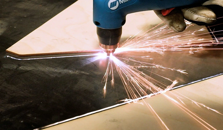

For straight cuts, one tool that may come in handy is a standoff roller guide. Fix the guide to the standoff and roll the cutter along a straight edge. The roller also allows you to maintain the recommended standoff distance. This maximizes cutting performance and keeps your tip in good shape for longer.
Remember to keep the gun perpendicular while cutting. If the gun is angled, it will create a beveled edge. If you need to see the cutting arc, angle your head to the side for a better view.
Use your non-cutting hand as a brace to maintain the proper position. Rehearse it beforehand to ensure that you can make the cut without changing position.

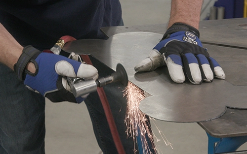

The dross that remains after the cut can be knocked off easily using a piece of scrap metal. Consider using a grinder to finish the piece, cleaning up rough edges and providing another aesthetic element.
