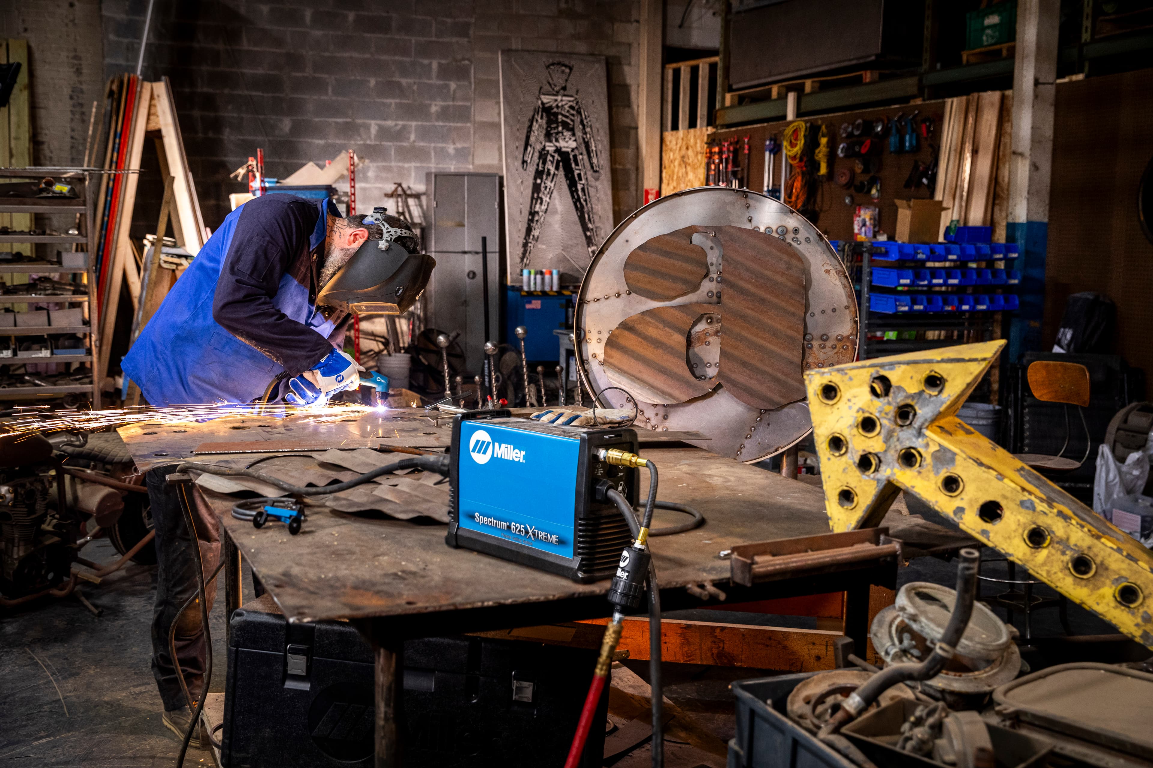

Plasma Cutting Application_Spectrum 625_House of Rad_Brandon Minga_MJL4397

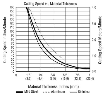

Cutting speed
Knowing cutting speeds for the thickness of metal being cut allows you to calculate production rates, typically in parts per hour. This helps ensure that the cutting portion of the operation does not become a bottleneck. Many manufacturers provide cutting speed charts that allow you to compare cutting speed performance.
pcuttinggif
To determine the maximum rated cutting thickness of mild steel, follow the line from the 15 IPM (inches per minute) point on the cutting chart. The point at which this line intersects the cutting curve determines the maximum recommended production cutting thickness of the unit. Note: the rating is based on 15 IPM because that is the minimum speed at which the operator achieves a smooth, steady cut when using a hand-held torch.
