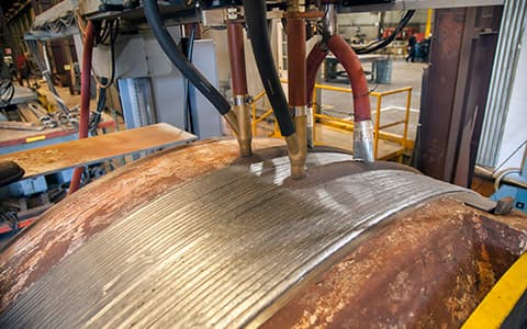

Twin-wire torch configurations utilize a single power source and a single specialized torch that simultaneously feed two wires into the same weld pool. This configuration requires a relatively low capital investment for the specialized torch, wire-straightener and contact tips. The higher current density of smaller wires used here (up to 3/32 inch, typically) often increases deposition over a single wire at matching current, helping to keep heat input and the resulting welds consistent.
Conversely, tandem torch configurations demand a higher capital investment because they require two power sources, at least one of which must offer AC capabilities. Compared to twin-wire torch configurations, the ability to use even higher currents (from larger wires) improves deposition rates and provides faster travel speeds. Plus, the ability to adjust each wire’s angle, current and voltage offers greater overall flexibility. While using a DC lead arc/AC trail arc is the most common configuration, the use of an AC/AC configuration improves deposition when the penetration of the DC lead arc is not necessary.
For both options, it is important that the arc and/or work motion systems can handle an increase in travel speeds in order to gain the full productivity benefits. Also be aware that incorporating additional wires introduces complexity into the application that operations must control.

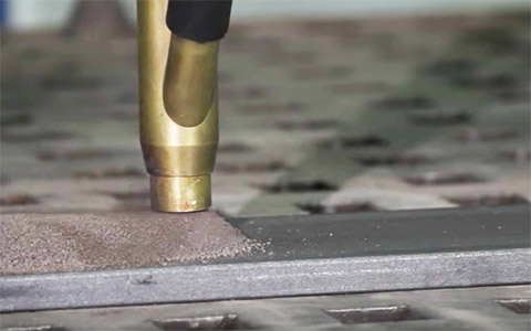

Flux is the defining component of the SAW process and choosing the proper one is critical. It accomplishes many more tasks than simply shielding the weld from the atmosphere. In many cases, improved productivity is a primary goal during formulation.
Flux formulation influences the fluxes’ current-carrying capacity — the maximum current where operations can obtain high-quality weld profiles and the highest possible deposition rates. Formulation also impacts slag release in that some are better suited for a given joint design (e.g. narrow groove welding). For example, fluxes that release well at low travel speeds (e.g. 16 inches per minute) may not release well at high travel speeds.

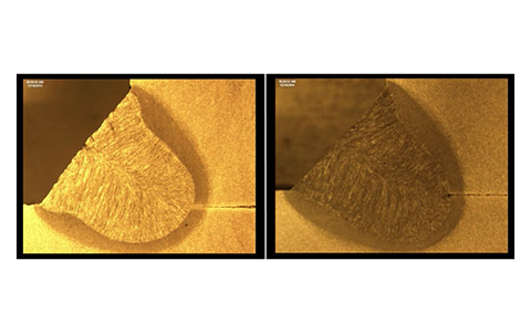

Fluxes for the SAW process are available in active and neutral types. Unlike neutral fluxes, active fluxes contribute significantly to the manganese and silicon composition of the weld. These elements help to clean the weld, and can help maintain tensile strength when welding at higher input heats or high-dilution. Active fluxes help the welds wet out smoothly and provide good slag release when welding at higher travel speeds or when the base metal is rusty, scaly, or dirty, reducing the risk of poor quality welds and time consuming pre- and post-weld cleaning. However, active fluxes should typically only be used for single or two-run welding, as excessive alloying that would occur in large multi-pass welds can contribute to brittle, crack-sensitive welds. Instead, use neutral fluxes in these applications to obtain good weld quality.
As a rule of thumb for neutral fluxes: select a flux with the lowest basicity index that provides acceptable mechanical properties. Low-basicity fluxes tend to improve overall operating characteristics, especially when using high-productivity (hot and fast) parameters. High-basicity fluxes tend to offer improved toughness under most conditions, but not always at high heat inputs. Consult with a flux manufacturer to help make a suitable choice for a given application.

Metal-cored wires are an option to improve productivity. The design of these wires can provide higher deposition rates and faster travels speeds, along with a wider, shallower penetration compared to solid wire welded at the same current.
These wires’ ability to achieve high travel speeds can be used to reduce heat input and minimizing weld distortion. The lower heat input can also, in some instances, improve mechanical properties. Likewise, these wires can help minimize the risk of burn-through and subsequent rework. Sometimes, they can even eliminate the need to MIG weld a hot pass. In many cases, metal-cored wires can weld on relatively thin materials or joints with less than ideal fit-up while still using high-current, productive welding parameters.
Note, metal-cored wires may not be suitable for thick square or narrow groove joints, nor do they provide maximum benefits using AC.
