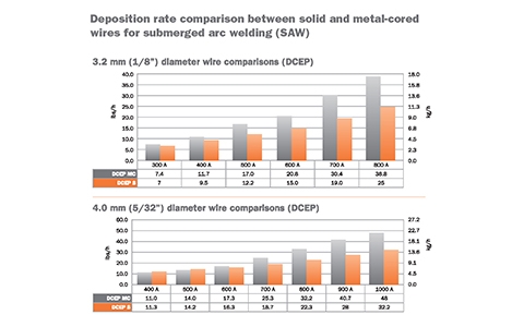

SAW can use both solid and metal-cored wire. Depending on the application, operations should consider each to achieve the desired results.
Metal-cored wires can offer increased travel speeds that result in even higher deposition rates with the same heat input. Cored wires also tend to have wider, shallower penetration profiles than solid wire, which helps to minimize the potential for burn-through on relatively thin materials or during root passes. In addition, cored wires can be filled with alloying elements to improve mechanical properties or offer additional solutions for high strength materials and high temperature applications.

The much greater deposition rates that SAW offers is one of the biggest benefits of the process. Deposition rate refers to the amount of filler metal melted into the weld joint — defined by pounds per hour.
Single wire SAW applications can achieve deposition rates of up to 40 pounds per hour, depending on wire size, type and polarity. Operations can further increase deposition rates by using a tandem torch option or pairing the process with metal-cored wire.
