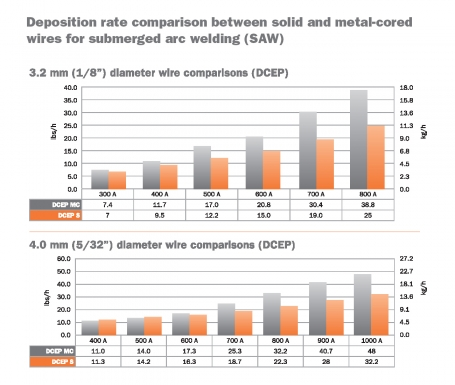

The primary advantage of this wire design is increased welding deposition rates. Cored wire can also be used to alloy the weld to compensate for high heat input and high dilution welds. In addition, the introduction of basic elements into the core composition can reduce oxygen content in the weld deposit to increase toughness.
The development and production of cored wires can be quite flexible and responsive. This helps meet evolving industry trends and application requirements, offering flexibility in some applications.
Cored wires are, for many applications, a higher productivity alternative due to their greater deposition rates.
Cored wire requires greater wire feed speed to achieve a given amperage compared to a solid wire of the same diameter and welding contact-tip-to-work distance. This is due to the increased current density and resistive heating effect of cored wire. The energy of the arc is generally concentrated to the wire's solid outer “sheath” as opposed to the powdered core.
Increased deposition rates provide the ability to put more metal down in the same time compared to solid wires. This can be done without significantly changing amperage and voltage.
When deposition rates increase, it's often possible to use higher travel speeds than solid wires and still maintain a given weld size. This presents an opportunity to improve productivity by speeding up the process and reducing the time to complete a weld.
