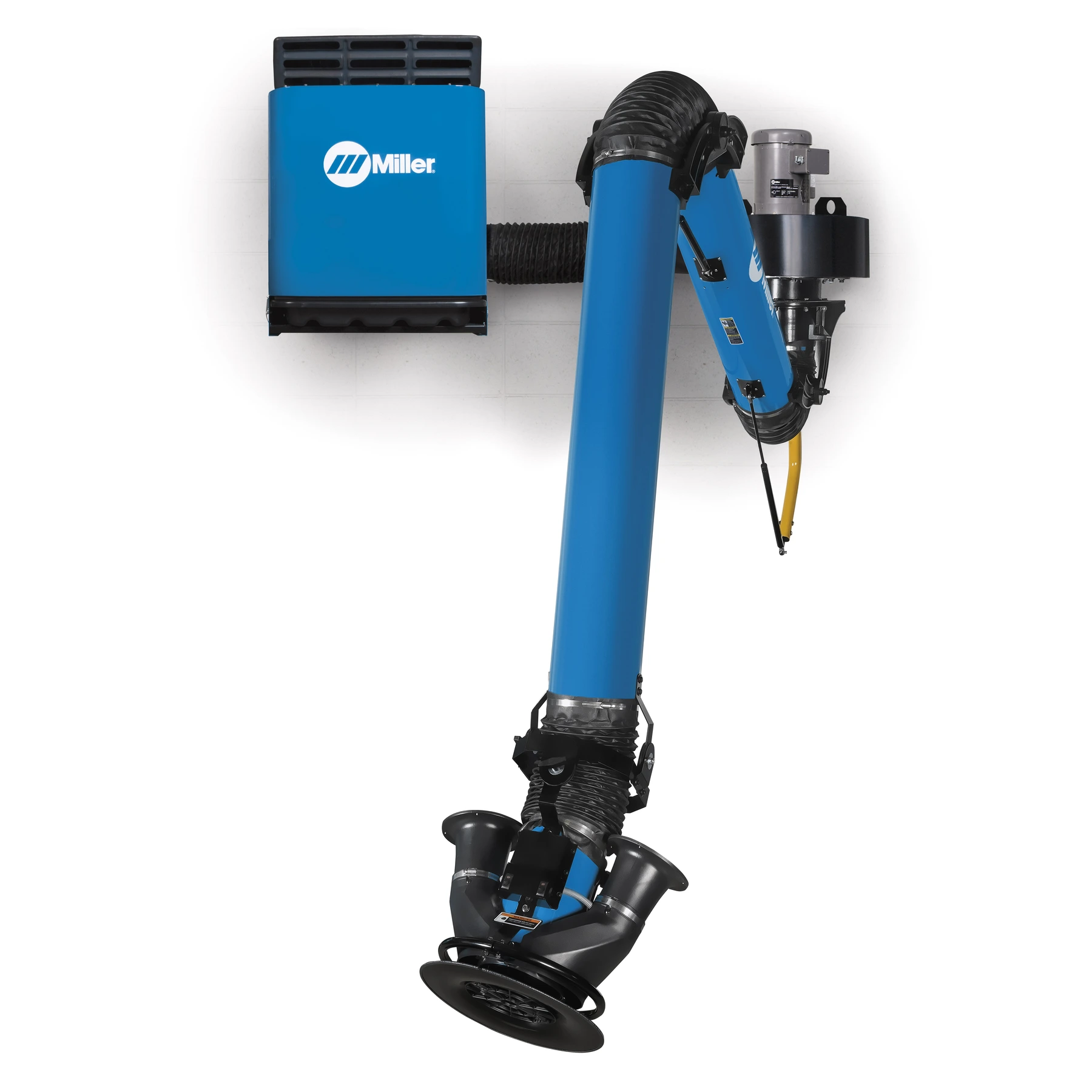

  • ZoneFlow™ Technology
    Creates a negative pressure zone that funnels air to the center of the arm from greater distances, up to 5 feet away.
  • Easy-to-Operate ZoneFlow™ Arm
    Arm with external adjustments so air can pass through with less airflow resistance, giving you stronger CFM (airflow). It offers reliable and accurate positioning across the full range of motion of the arm, as well as easy adjustment and maintenance to ensure long-lasting operation. Extraction arms are available in 10- or 12-foot lengths.
  • Less Arm Movement
    With a capture zone that is 3 times larger than traditional systems, users have less interaction with the arm, increasing arc-on time and productivity.
  • MERV 16 Filter Rating
  • Self-Cleaning Filter Model
    Ideal for high arc-on time environments the self-cleaning filter model is designed to capture weld fume particulate with a cleanable filter and safety deposit them in an integrated particle bin, the self-cleaning model provides unrivaled filtering performance.
  • One Minute Cleaning Cycle
    The one-minute filter cleaning cycle is as easy as the push of a button on the control panel. Latches release a disposal drawer allowing it to slide out to provide easy and convenient access to empty out the collected particles. (Compressed air is required to operate this cleaning mechanism)
  • Class Leading Suction Power
    High-performance fan generates 1,200 cfm to better capture weld fumes and provide a cleaner environment.
  • Dual Fan Capture Zone
    Keep both sides of the fans turned on for a 360 degree capture zone or turn one side off to position next to a wall or curtain for a 180 degree capture zone.
  • FILTAIR® SWX System Arm Add-On Packages
    Easy to order and allow the flexibility to mix different arm types to solve various fume extraction challenges (See Accessories).
