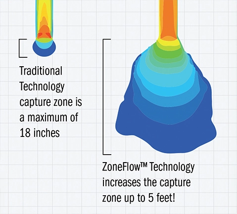

Large Capture Zone
Designed specifically for welding, ZoneFlow™ Technology captures weld fume up to five feet from the arc compared to traditional systems requiring the hood to be placed within 18 inches from the arc for effective fume capture.

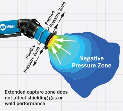

ZoneFlow™ is a patented airflow technology that creates an extraction zone where the air on the inside of the zone has lower pressure than the air on the outside. The air pressure difference causes weld fume to get funneled to the center of the extraction arm, maximizing the weld fume capture distance.
traditional vs Zoneflow 2
Positive Negative Pressure 2

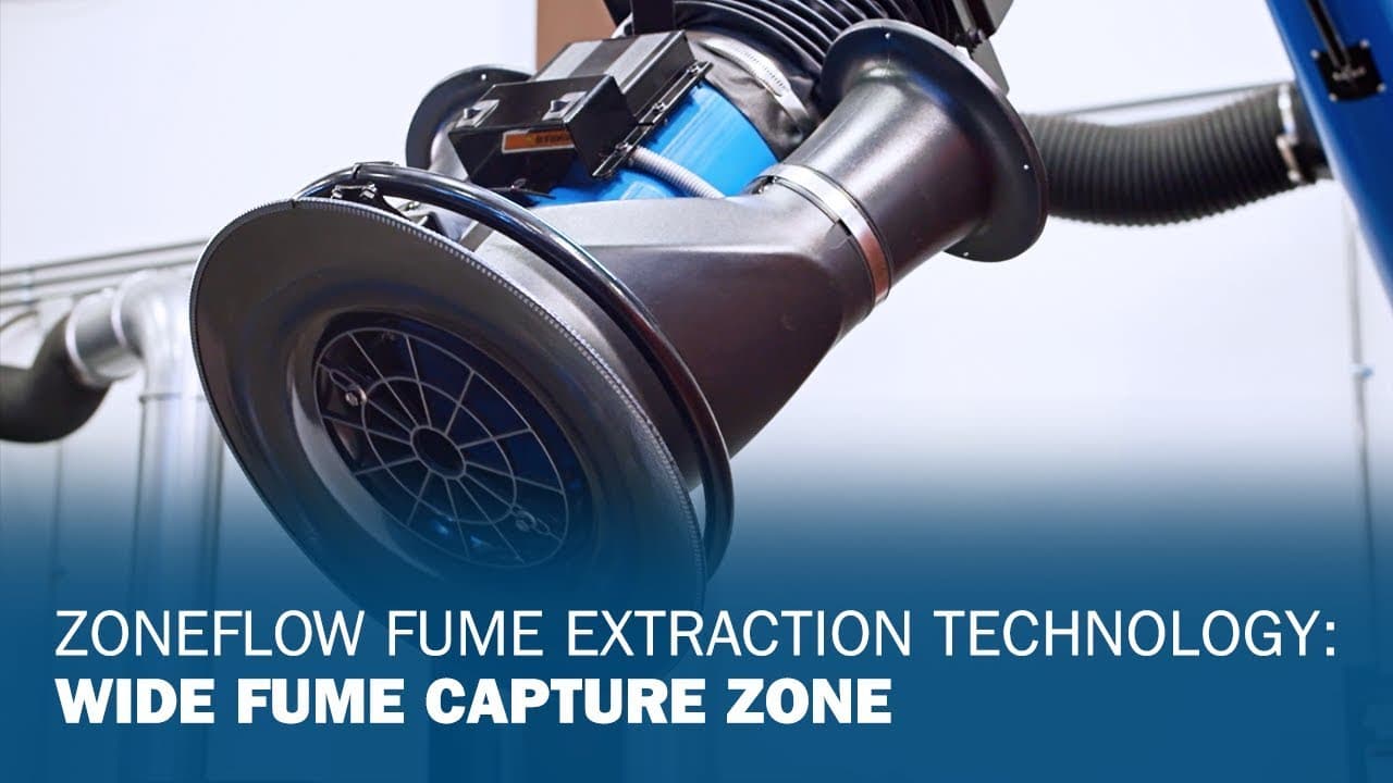

ZoneFlow Fume Extraction Technology: Wide Fume Capture Zone
