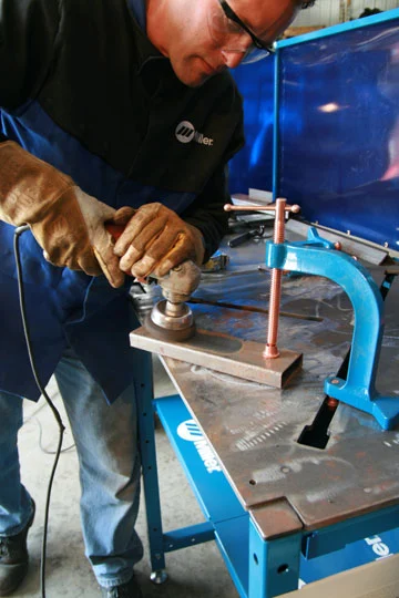

Preparing metal for welding
As mentioned earlier, flux-cored welding is more tolerant of surface contamination than MIG welding. However, you should always clean the surface of the base metals as thoroughly as possible to ensure that a rusty or scaly surface does not contaminate the final weld. A metal brush or grinder works well for cleaning the base metals. Also, be sure to clean the portion of the base metal where you plan to attach the ground clamp. Poor contact with the ground clamp will create resistance in the welding circuit and could result in poor weld quality.
For material over 1/4 inch, it’s usually a good idea to bevel the edges of the base materials to ensure complete fusion of the two parts. This is especially true for butt joints.
img9605jpg
Although flux-cored welding is more forgiving of dirty metal than MIG welding, it’s still a good idea to clean off as much surface contamination as possible prior to welding.

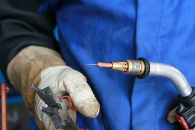

Setting your wire stickout
Stickout refers to the length of unmelted electrode extending from the tip of the contact tube, excluding the arc length. Generally, flux-cored welding requires a stickout of around 3/4 inch, which is about twice the recommended stickout for MIG welding.
img9657jpg
A stickout of approximately 3/4 inch is recommended for flux-cored welding

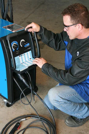

Determining voltage and amperage needs
How much voltage and amperage a weld requires depends on metal thickness, joint configuration, welding position and wire diameter. Reference charts are available on your power source to help set the correct voltage and wire feed speed based on the wire diameter and material thickness. Our flux-cored welding calculator is also a great tool to utilize. Consider these tools to be rough guides from which you can fine-tune your final parameters based on a few test welds.
img9644jpg
Your power source contains reference charts for setting the correct electrical and wire feed parameters.

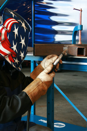

FCAW gun technique: push or drag?
With flux-cored welding, you should always use a drag (pull) technique. This involves pointing the tip of the welding gun back at the weld pool and dragging it away from the completed weld. An easy rule of thumb for remembering which technique to use is “If there’s slag, you drag.”
Use a standard travel angle
Travel angle is the angle relative to the gun in a perpendicular position within the plane of the weld joint. Normal welding conditions in all positions call for a travel angle of 5 to 15 degrees. Travel angles beyond 20 to 25 degrees can lead to more spatter, less penetration and general arc instability.

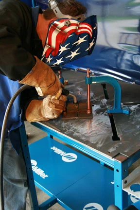

Welding in a flat position
For a butt weld (a 180-degree joint), hold the gun at a 90-degree work angle — the same angle from each workpiece. Direct the filler metal straight into the joint with a 5- to 15-degree travel angle. A small side-to-side motion with the gun can help fill a large gap or when making multiple passes. Pausing slightly at the sides of a weave bead can help avoid undercut.
img9774jpg
For a T-joint (a 90-degree joint; the type of weld on this joint is called a fillet weld), position the gun at a 45-degree angle, or equal distance from each piece. When making multiple weld passes, adjust the work angles slightly toward one side and then the other to avoid uneven weld beads and undercuts.

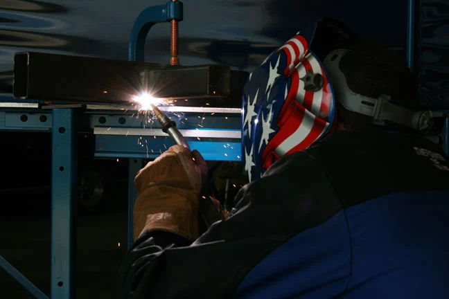

Overhead position
An overhead weld is the most difficult weld to make, and it should be avoided if possible. If you cannot avoid welding in the overhead position, try using the smallest wire possible, lowering your welding parameters by 15 to 20 percent, keeping your weaving to a minimum and maintaining a fast travel speed. Even following these tips, it still may be difficult to achieve a sound overhead weld.
img9851jpg
Overhead welds are tricky. Use a thin wire, fast travel speed and turn your electrical parameters down by 15 to 20 percent.
