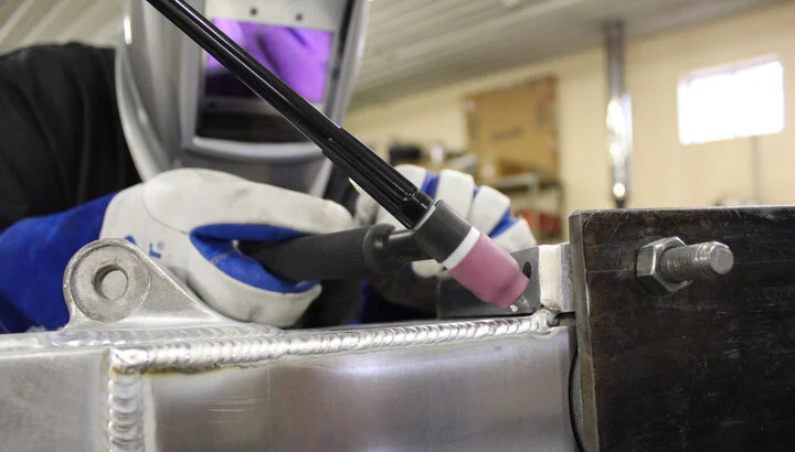

TIG welding can often avoid the problem with lack of fusion at the beginning of welds since the weld puddle can be established prior to the filler metal being added. In the case of lack of penetration, increasing the amperage or utilizing more electrode negative amperage will put more heat into the weld zone.
2. Burn-through: On the opposite end of the spectrum, too much heat can also cause problems. Excess heat input may be caused by setting voltage or wire feed speed too high or by too slow of a travel speed. This can lead to burn-through, especially on thinner-gauge aluminum. Generally, aluminum requires a faster travel speed than steel to avoid heat buildup. Overwelding also adds more heat and can result in burn-through. When TIG welding, reduce the welding amperage or add more filler material rod (by increasing the rod diameter or pushing more length in at each addition). This has the same effect as putting an ice cube in a drink; it cools the puddle down.
