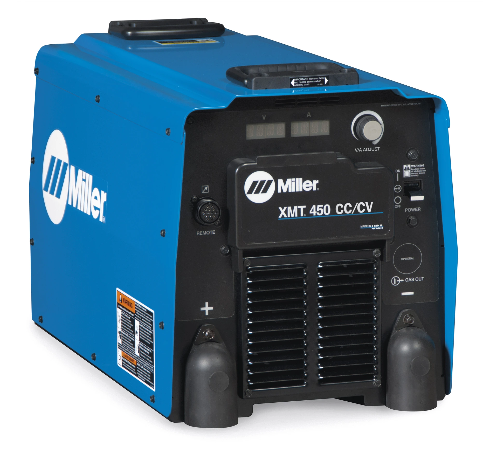

  • ArcReach® Technology
  • Control Panel Lock Out
    Inadvertent parameter changes by other jobsite workers can be avoided because connecting an ArcReach accessory to the power source automatically locks out the power source’s panel controls.
  • Auto-Process Select™
    Automatically sets the power source to the correct weld process based on the polarity applied to the weld accessory and decreases the chance of an incorrect weld process.
  • Standard 14-pin Receptacle
    Has the flexibility to be used with spool guns, feeders, and remote controls.
  • Wind Tunnel Technology™
  • Advanced Features for the Professional Welder
  • Improved Weld Quality
    Operators can precisely set arc voltage at the feeder and monitor the actual arc voltage and current delivered to the weld using the digital meters on the feeder. This removes guesswork when it comes to adhering to weld procedures.
  • Remote Override of XMT
    When an ArcReach feeder is connected to an XMT the feeder has full control and the XMT controls are disabled. While under ArcReach control, process and V/A adjustments are locked out, preventing accidental changes by personnel other than the welding operator.
  • Welder friendly control panel
    Process selector switch reduces the number of control setup combinations without reducing any features. Ultra-tough, polycarbonate-blended cover protects front controls from damage. Large, dual digital meters are easy to view and presettable to ease setting weld output.
  • Increased Productivity & Safety
