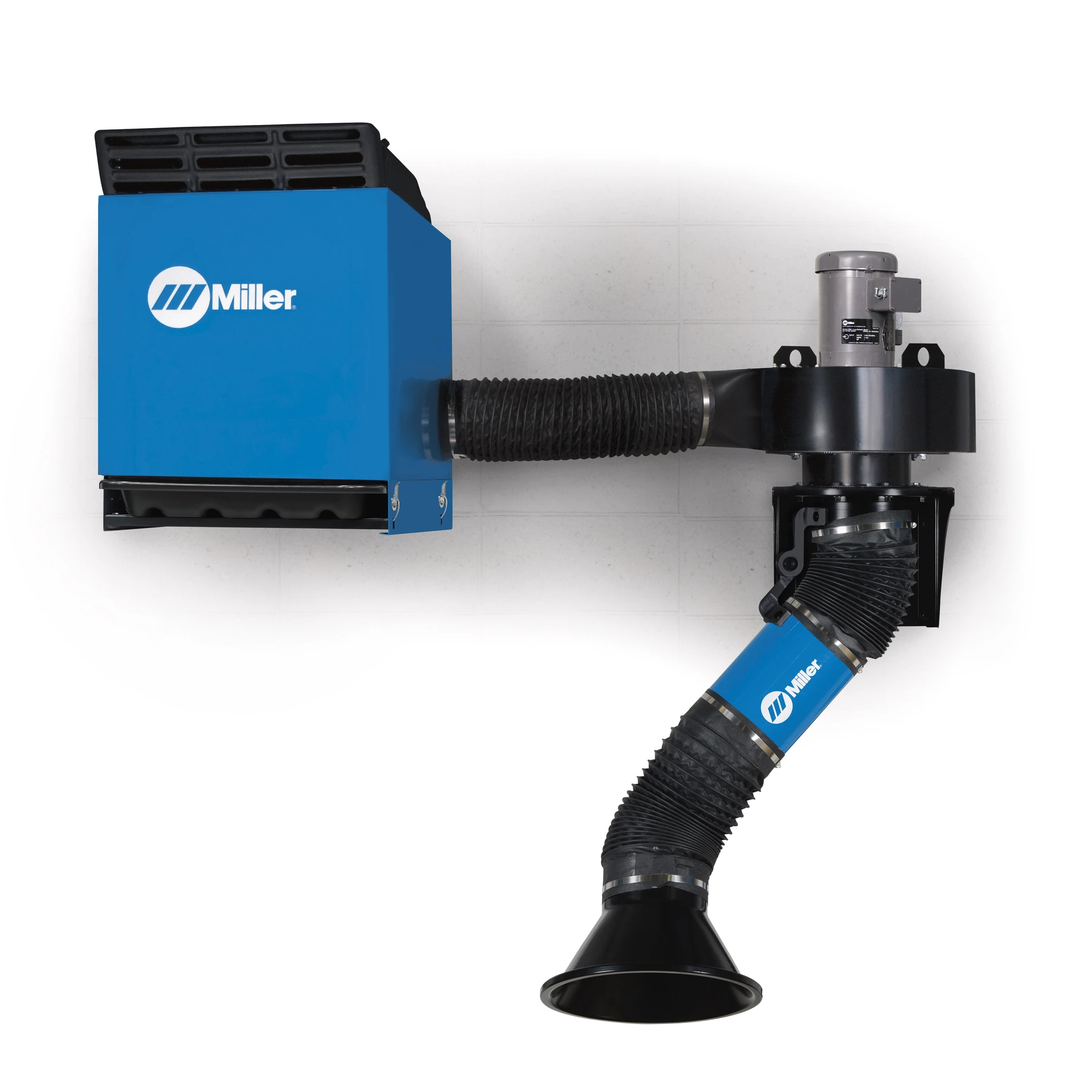

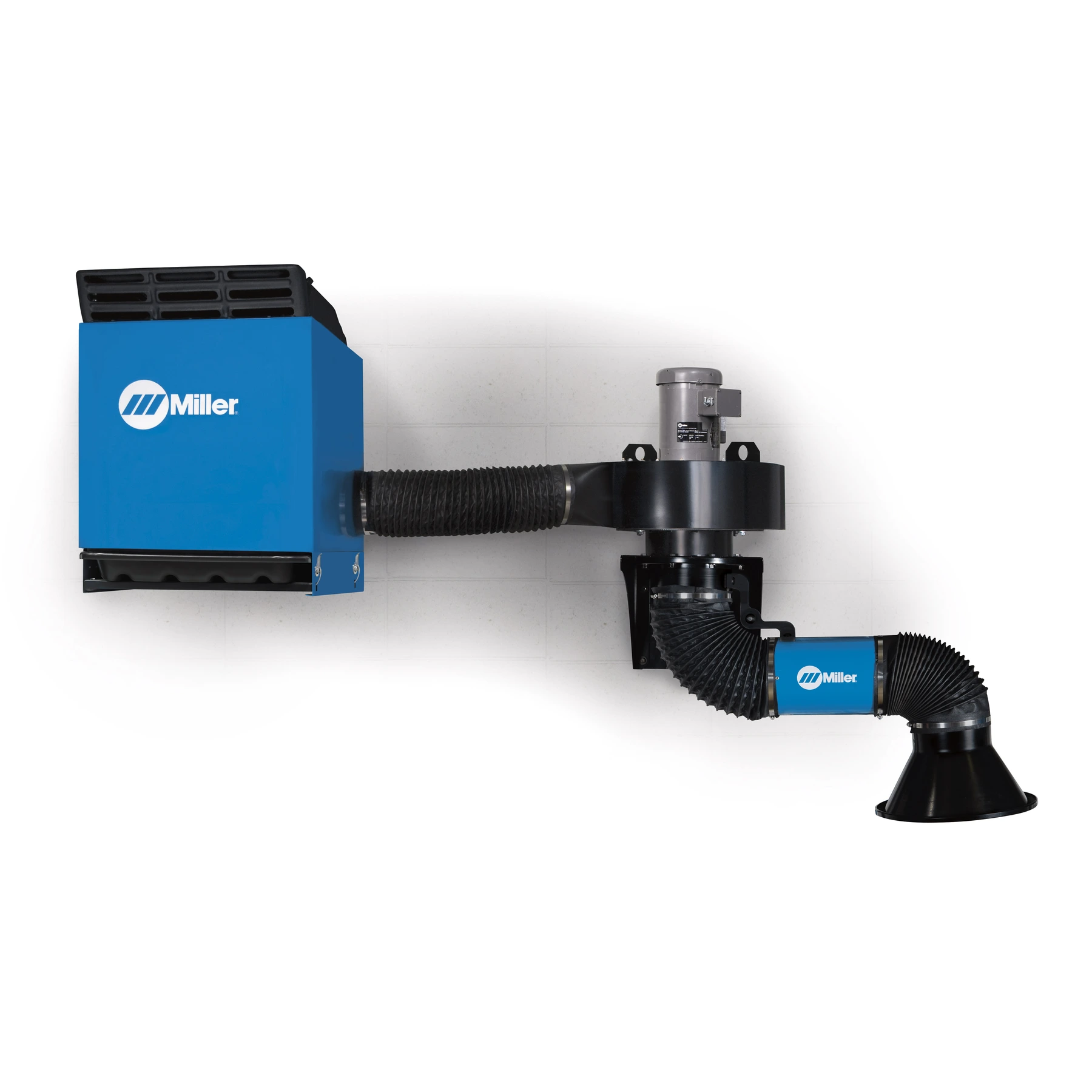

  • Easy-to-Use Telescoping Arm
    Ideal for small spaces and offers reliable and accurate positioning across the full range of motion of the arm. Easy adjustments and maintenance ensures long-lasting operation. Pre-assembled telescoping arms can extend from 3 to 4.5 feet.
  • Durable Bellmouth-Shaped Hood
    Features a convenient 360 degree rotation for unlimited positioning. One of the largest in the industry, FILTAIR’s extraction hood captures weld fumes at a greater distance from the source than other hood designs. This also means less hood adjustments for longer welds.
  • MERV 16 Filter Rating
  • Self-Cleaning Filter Model
    Ideal for high arc-on time environments the self-cleaning filter model is designed to capture weld fume particulate with a cleanable filter and safety deposit them in an integrated particle bin, the self-cleaning model provides unrivaled filtering performance.
  • One Minute Cleaning Cycle
    The one-minute filter cleaning cycle is as easy as the push of a button on the control panel. Latches release a disposal drawer allowing it to slide out to provide easy and convenient access to empty out the collected particles. (Compressed air is required to operate this cleaning mechanism)
  • Class Leading Suction Power
    High-performance fan generates 1,200 cfm and creates an Accu-Rated minimum of 875 cfm extraction at the hood to better capture weld fumes and provide a cleaner environment.
  • FILTAIR® SWX System Arm Add-On Packages
    Easy to order and allow the flexibility to mix different arm types to solve various fume extraction challenges (See Accessories).
