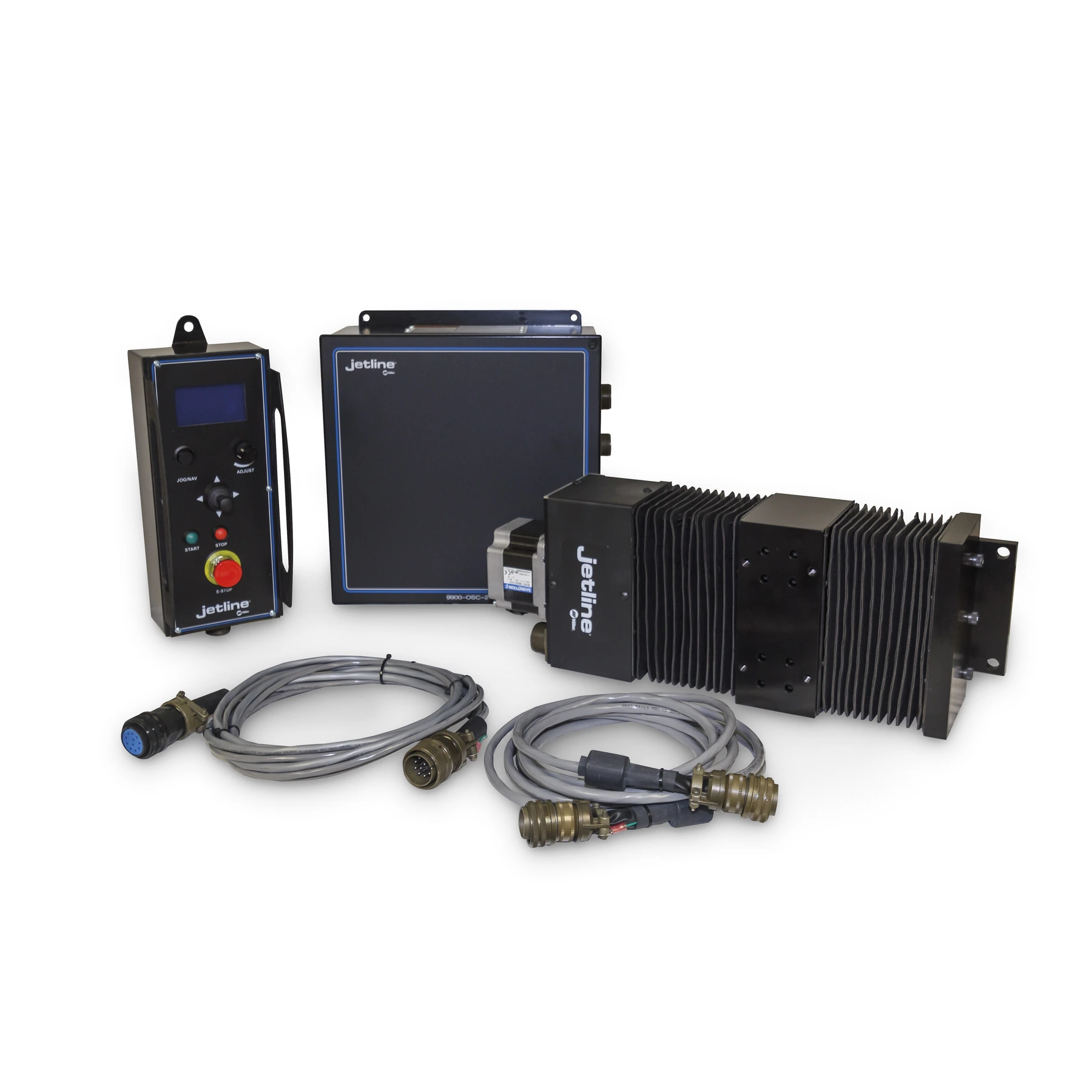

Jetline has two mechanical oscillator systems, the JMO-150-5 and the JMO-80-2. The mechanical oscillator systems consist of a control module, pendant and a motorized slide assembly. Mechanical oscillator systems can be integrated into new Jetline systems, or purchased as a bolt-on package for existing systems. Oscillators can be interfaced with a Jetline 9700T or 9900 controllers.
The 9900-OSC-2 Control and the 9780MSP Pendant have the following features: Left oscillation speed control, Right oscillation speed control, left dwell adjustment, Right dwell adjustment, Oscillation width adjustment, Center adjustment, Taper time at the end of the weld, Microprocessor design, Micro-stepper drive, allows for four programs to be saved.

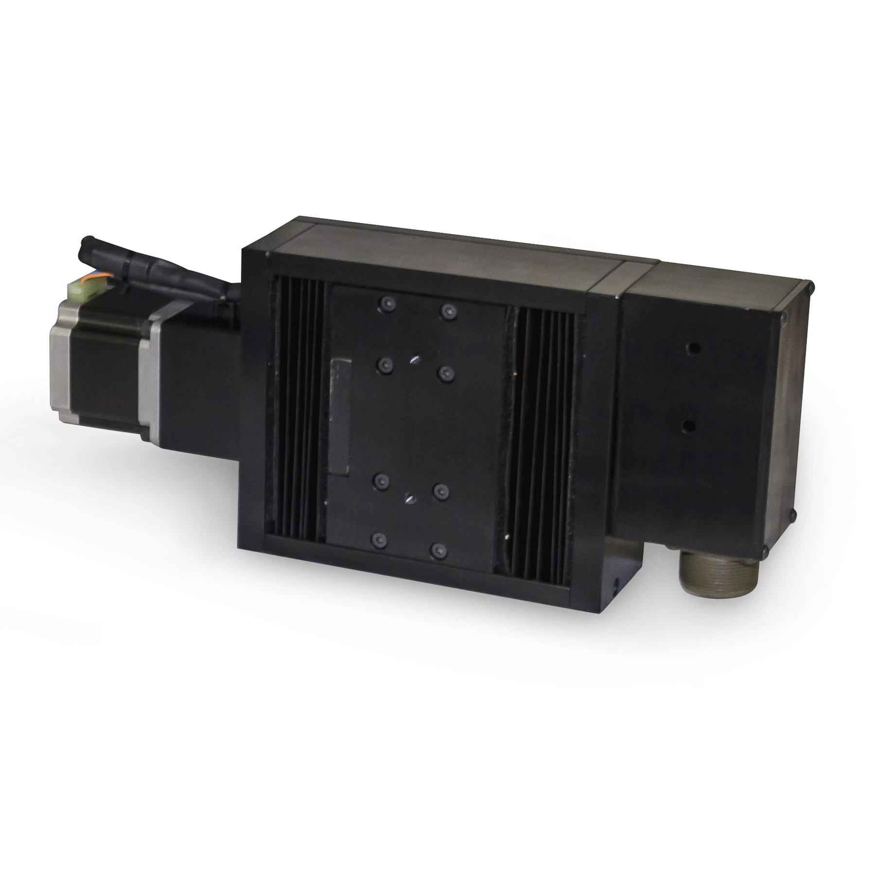

Two Oscillator slide options are available, 2 in. and 5 in. stroke capability. The slide assembly includes the following features: Rigid aluminum housing, Precision linear guide rails, Ball screw with ball nut drive assembly, High speed, high torque stepper motor drive, 10 ft. interconnection cable, 80 lbs. at 2 in. from mounting face (2 in. stroke model), 150 lbs. at 2 in. from mounting face (5 in. stroke model).
