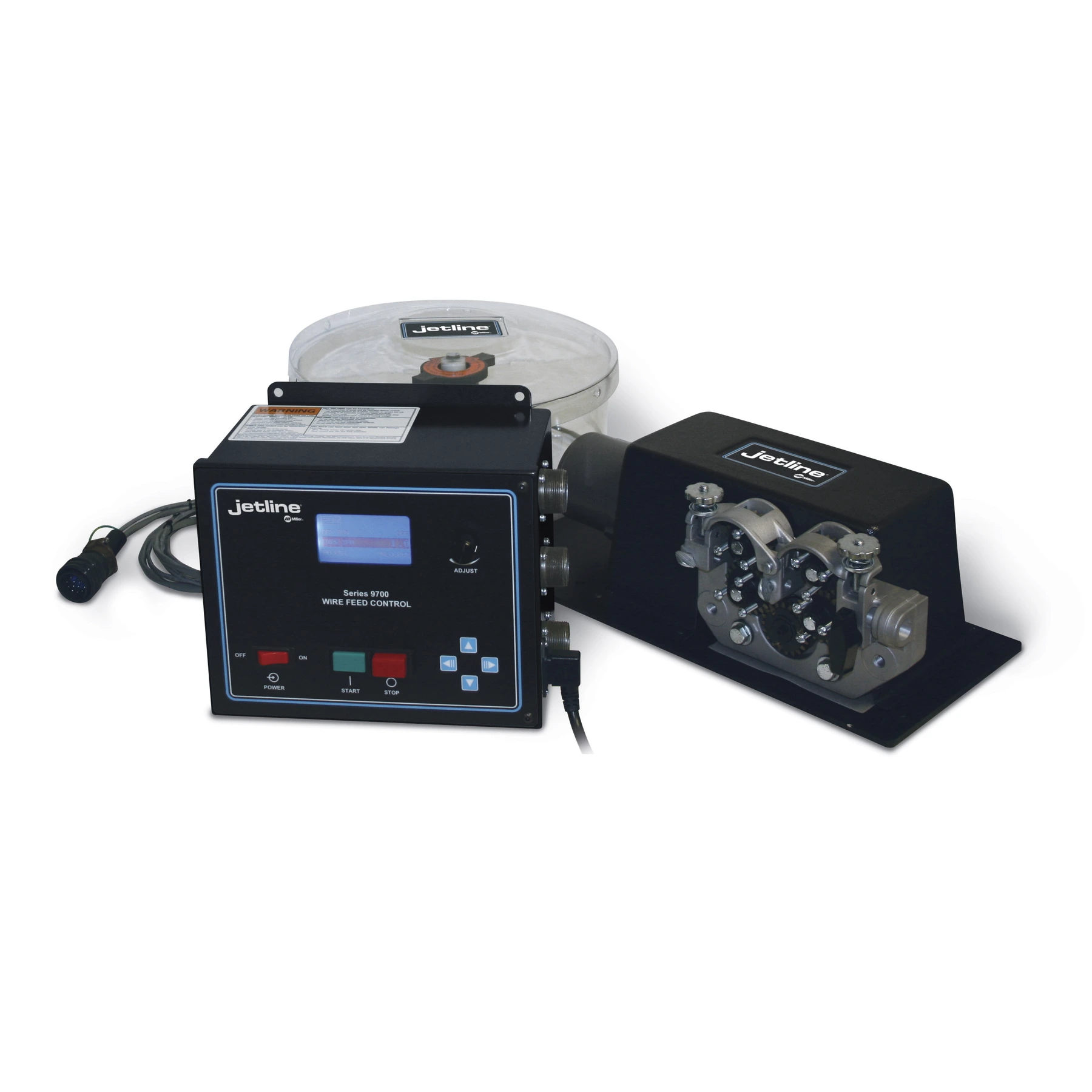

  • Cold Wire Feeder System
    Jetline cold wire feeder system includes: 9700W microprocessor control, 4 roll feed assembly, and wire guide positioner.
  • 4 Roll Feed Assembly
    Wire drive assembly consists of a 4 drive roll system controlled by the 9700W Control. Optimizes feeding of both hard and soft wires. Includes 8' cable from drive assembly to 9700W.
  • Wire Guide Positioner Assembly
    Wire guide positioner assembly mounts to the welding torch with a universal bracket with fine adjustment to position where the wire enters the weld puddle.
  • Wire Feed Accessory Kits
    Accessory kits (sold separately) are required for each wire size being used. Kits for the following wire sizes are available: 0.020", 0.030", 0.035", 0.045" & 0.062". Each kit consists of: 4 Drive Rolls, Inlet Guide, Intermediate Guide, Outlet Guide, 6' Wire Conduit, Wire Guide Tip.
  • Optional Clear Spool Cover
    A transparent cover designed to protect the wire from the dust and dirt of the manufacturing environment
  • 3 Year Warranty
  • 9700W Microprocessor Controller
    The 9700W control is user-friendly and uses simple menu commands to guide the operator through the setting up and operation of the unit. Functions include Setting of wire feed speed, setting of wire start delay time, setting of wire stop delay time, wire Jog before start of weld, Wire retract at end of weld.
