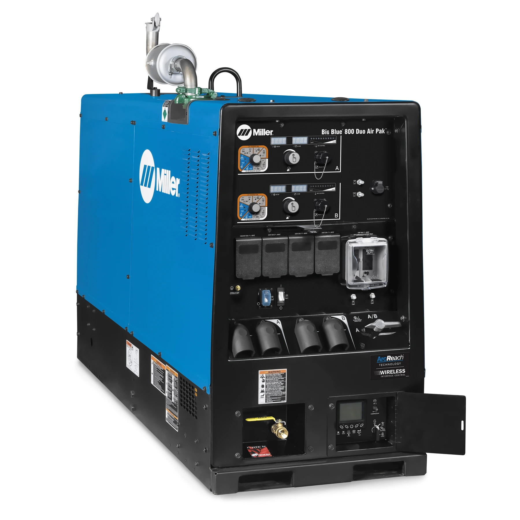

The cleanest, greenest diesel power available. Utilizes Diesel Oxidation Catalyst (DOC) technology to keep the air clean with NO exhaust aftertreatment maintenance.
Ultra-reliable industrial rotary screw air compressor. 30,000-hour life expectancy. Independent on/off control for applications not requiring compressed air — allows greater fuel savings and longer compressor service intervals.

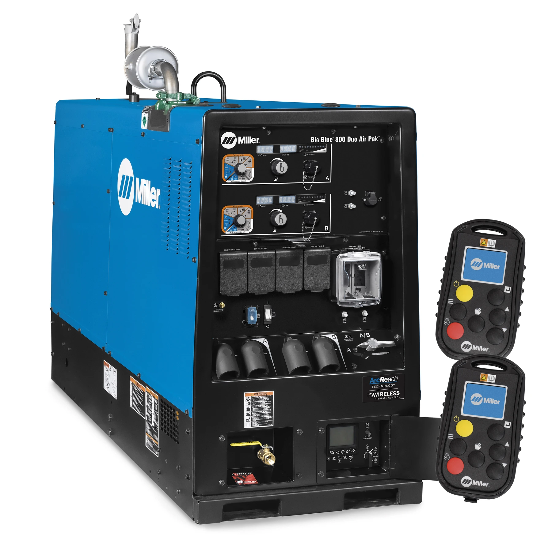

Get full control of your machine in the palm of your hand, from wherever you are on the jobsite, so you can work hassle free. With wireless interface control you can: Change welding processes, adjust parameters, Select and save preset programs, turn the machine on/off, View service reminders and more! Extend time between fill ups and maintenance intervals while eliminating the need to go back to your machine to make adjustments.

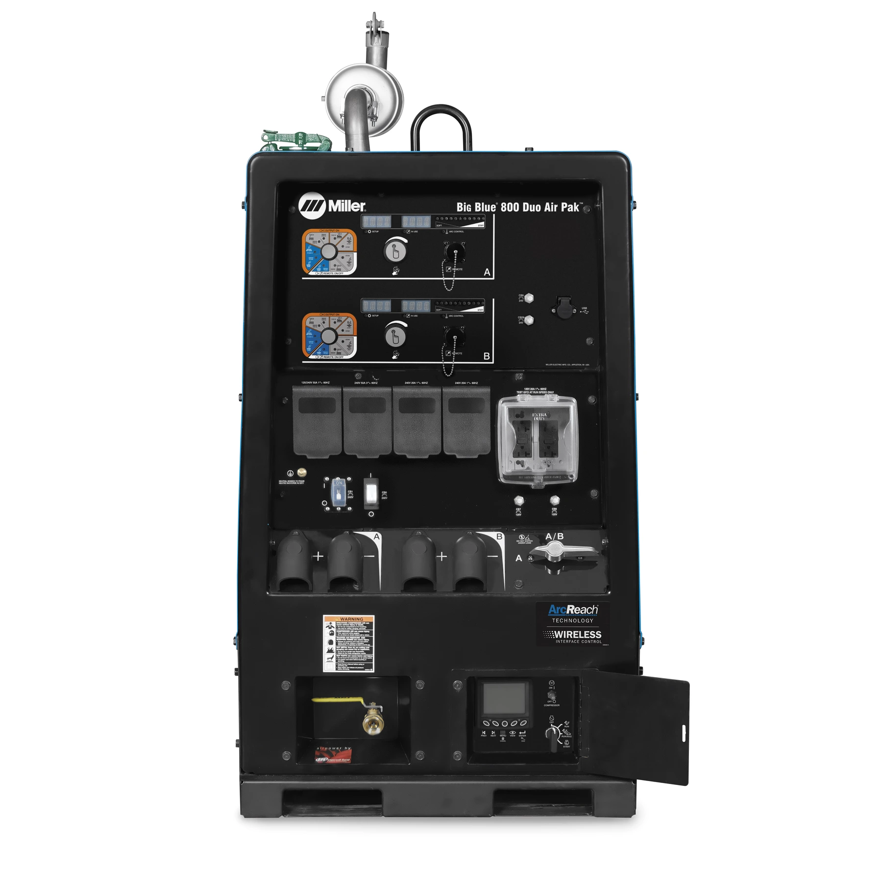

Critical controls are located within easy reach for a ground-based operator when the machine is mounted on the bed of a large-body truck.
Electronic engine display simultaneously displays fuel level, engine hours, coolant temperature, oil pressure, battery volts, and engine RPMs. Also tracks oil change intervals and displays engine diagnostics for quick and easy servicing.
One dependable engine - two independent arcs with up to 400 amps each (or 800 amps for a single operator). Plug in additional inverter welders for a true multi-operator (3+ arc) work platform!
When activated, reduces the open-circuit voltage to 15 volts when the power source is not in use, increasing operator safety without compromising arc starts.
