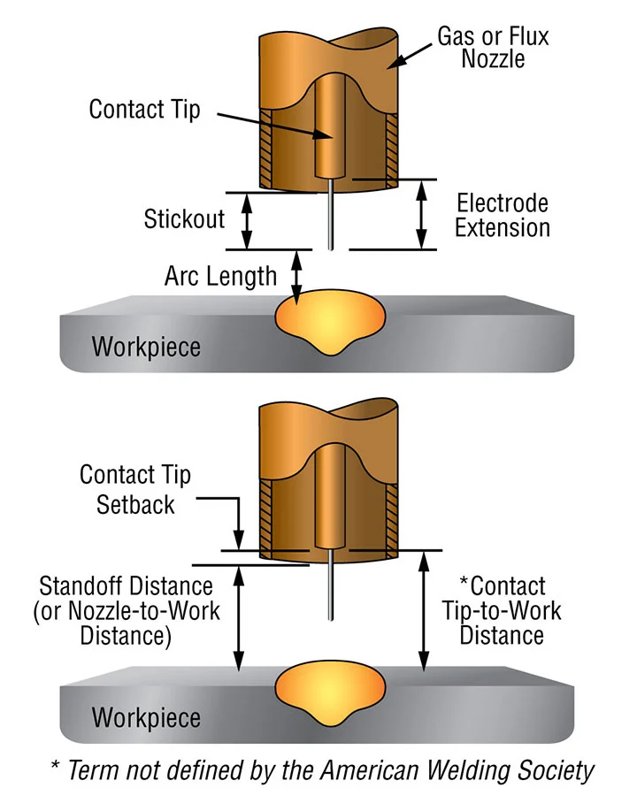

Achieving the right parameters to get the results you want requires understanding and using proper welding terms. Here’s an example I see frequently across the industry: People often use electrode extension, stickout and contact-tip-to-work distance interchangeably.
But these terms measure different things, and using them interchangeably — or not understanding their proper meanings — can cause confusion that alters weld parameters and, ultimately, weld quality.
So, how do electrode extension, stickout and contact-tip-to-work distance differ? Let’s talk about each one and why it’s important to use the proper term.
Changing the distance between your welding gun and the workpiece affects the amount of resistance in the welding circuit, and a change to the resistance also alters amperage in a constant voltage process like gas metal arc welding (GMAW). To help ensure and maintain proper amperage in your application, it’s important to know the meaning of these common terms and how they differ:
Electrode extension
As defined by the American Welding Society (AWS), this refers to the length from the end of the contact tip to where the wire melts off.
Stickout
Another common term defined by the AWS, this refers to the end of the nozzle to where the wire melts off. The only time that electrode extension and stickout can be used interchangeably is when the contact tip is flush with the end of the nozzle. In instances where the contact tip is recessed, these two terms refer to different distances.
Contact-tip-to-work distance
While this is a commonly used industry term — even in many weld procedures — it’s not actually defined by AWS A3.0 Standard terms and definitions. The best time to measure contact-tip-to-work distance is when you’re preparing the weld or programming the robot, and you can take a physical measurement before you strike the arc. Once the arc is struck, measure arc length by voltage, and electrode extension by resistance in the circuit or with sight. When people use the term contact-tip-to-work distance, they often mean the sum of arc length and electrode extension.
Maintaining consistent electrode extension during welding is critical because varying the extension can change your amperage. This can put you out of range of your welding specifications. When that happens, you may be depositing a weld that’s less than sound.
Too short of an electrode extension increases the amperage and brings you closer to the weld pool. This can cause premature damage to the contact tip and create burn-through from too much heat. Too much extension lowers the amperage and can result in poor penetration that requires rework.
Consider this example of GMAW in spray transfer mode using the same wire type, shielding gas, base metal and nozzle diameter in both instances. The original contact-tip-to-work distance was 3/4 inch, resulting in 235 amperes. Simply changing contact-tip-to-work distance from 5/8 inch to 1 inch causes amperage to operate in a window from 282 to 213 — potentially putting you out of spec for the application.
This happens because increasing the distance increases resistance — and the amount of resistance can determine your weld quality. To see for yourself, try changing the electrode extension in your noncritical welding applications.
While AWS does not define contact-tip-to-work distance, it’s often the most logical term to use in welding applications. But it’s important to know that electrode extension, stickout and contact-tip-to-work distance all have specific definitions. Using them interchangeably can cause confusion that puts amperage out of the specified range.
Using the right industry standard terms when communicating globally about welding applications helps ensure alignment among all parties.
The bottom line: Understanding the terms and how they AWS defines them provides clarity to help prevent mistakes and rework.
