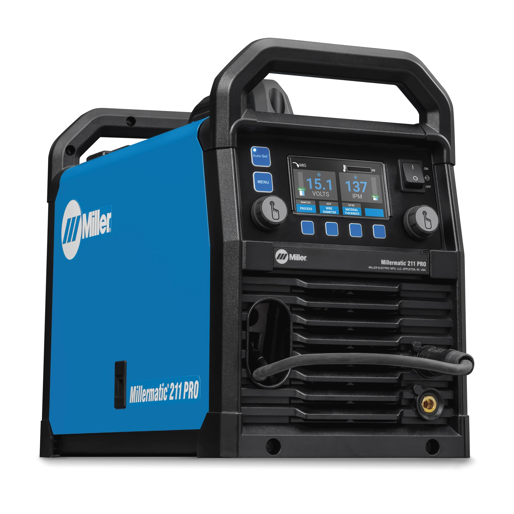

Duty cycle is the key driving factor for how long your welding machine can continuously operate before overheating. This matters because it’s a way to ensure the welding machine can handle the work required in one pass or if the work needs to be broken up into multiple passes.
Duty cycle is expressed as a percentage over a 10-minute period, so you divide the percentage by 10 to know the number of minutes the machine can operate before it needs to cool down. For example, the Millermatic® 211 PRO with a 30% duty cycle at 215A/240V can operate for three minutes continuously before needing to cool down for seven minutes.
On top of limiting how long you can continuously operate your welding machine, duty cycle can impact important outcomes, such as the quality of your weld. Extended use of the machine past its duty cycle can cause the machine to malfunction or overheat, which means you should use a machine that matches your project’s requirements.
Too short of a duty cycle at the amperage you need will require you to break up a large task into smaller tasks which may heat and cool the metal too frequently, resulting in warping. It’s also possible the machine is overheating, causing fluctuations in the heat input that result in poor penetration.
An additional factor is the length of time it will take you to accomplish a larger or longer weld. If you have a long, continuous structural weld, opt for a higher duty cycle welding machine that can handle extended use.
From a safety standpoint, exceeding the recommended duty cycle of a welding machine can pose a risk of degrading the lifespan of the internal components, which can result in a sudden and unsafe equipment failure. A higher duty cycle reduces the risk of fire or accidents that can occur due to overheating.
If you’re concerned about your machine’s longevity, choose a machine that has the right duty cycle for the job at hand. This is because too low of a duty cycle will cause the machine to overheat, but too high of a duty cycle could be unneeded and an over investment.
It’s important to know your duty cycle because it likely will be a limiting factor to how efficient your time spent welding is. Luckily, finding your welding machine duty cycle is a simple process. No matter the brand, your duty cycle chart will be located in your operator’s manual. Additionally, duty cycle charts are located on Miller machines.
To read a duty cycle chart, simply identify what amperage you’ll use, or if using a Millermatic 211 PRO with Auto-Set™, set the parameters and read the amperage displayed. From there, examine your duty cycle chart and follow the amperage line across to where it intersects with the duty cycle line. Directly below that intersection will list the duty cycle percentage.
While reading a duty cycle chart is straightforward, there are several factors that go into it, such as thermal overload protection, amperage, material thickness and voltage.
