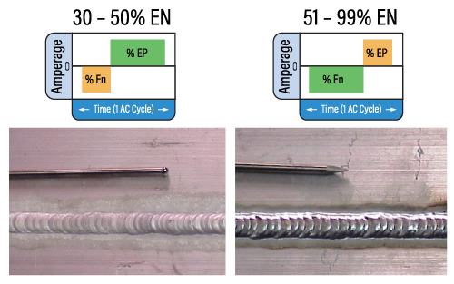

With modern Miller® TIG welders, the amount of time spent in EP and EN cycles is controllable. This is known as AC balance control, and the duration spent in each phase will impact a variety of factors.
Reducing the EN portion of the cycle provides greater cleaning action to remove heavier oxidation.
When a weld is too oxidized and an improper AC balance control is selected, the weld will appear to have an oxide skin on top of the material. This prevents the operator from being able to see the puddle, potentially causing common weld defects such as a poor weld appearance, porosity or lack of fusion. A telltale sign is the appearance of “pepper” in the weld puddle, which means more cleaning action is required to blast away oxides and other impurities they may be holding.
On the other hand, deformation and erosion of an operator’s tungsten rod can occur with too much of an EP cycle. This is due to the heat being applied to the tungsten rod during the EP portion and can result in an unstable arc. Often, the tungsten rod will melt and appear as a ball on the tip, referred to as balling, which leads to the weld being more difficult to control. Modern tungsten electrodes are made of alloys which have a much higher melting point, minimizing this impact.
For modern inverter welding machines like Syncrowave® or Dynasty® welders used on clean aluminum, a good starting point is setting the EN by utilizing the Pro-Set™ feature. On machines without Pro-Set, dirtier or older aluminum might require AC balance control settings as low as 65%, while very clean parts may allow the use of a higher setting closer to 80%. It’s a good idea to complete practice welds on scrap pieces before welding to determine the best balance control settings.
Fig. 3. A comparison between greater (left) and lesser (right) amounts of EN.
