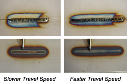

Fig. 1 DC TIG Comparisons: Slow travel speeds increase the width of heat-affected zone and can cause carbide precipitation on the backside of the weldment. Faster travel speeds, produced by high-speed pulsed TIG, can alleviate these quality issues while improving productivity.
Stainless parts can rust because excess heat concentrates carbon in the heat-affected zone, where it becomes trapped when the metal cools (see Fig. 1). Given time, the area overloaded with carbon will rust, a phenomenon commonly called carbide precipitation or “burning out the chrome.” When this happens, the stainless steel’s defining properties are changed, which may, in turn, result in in-service corrosion and increase warranty costs.

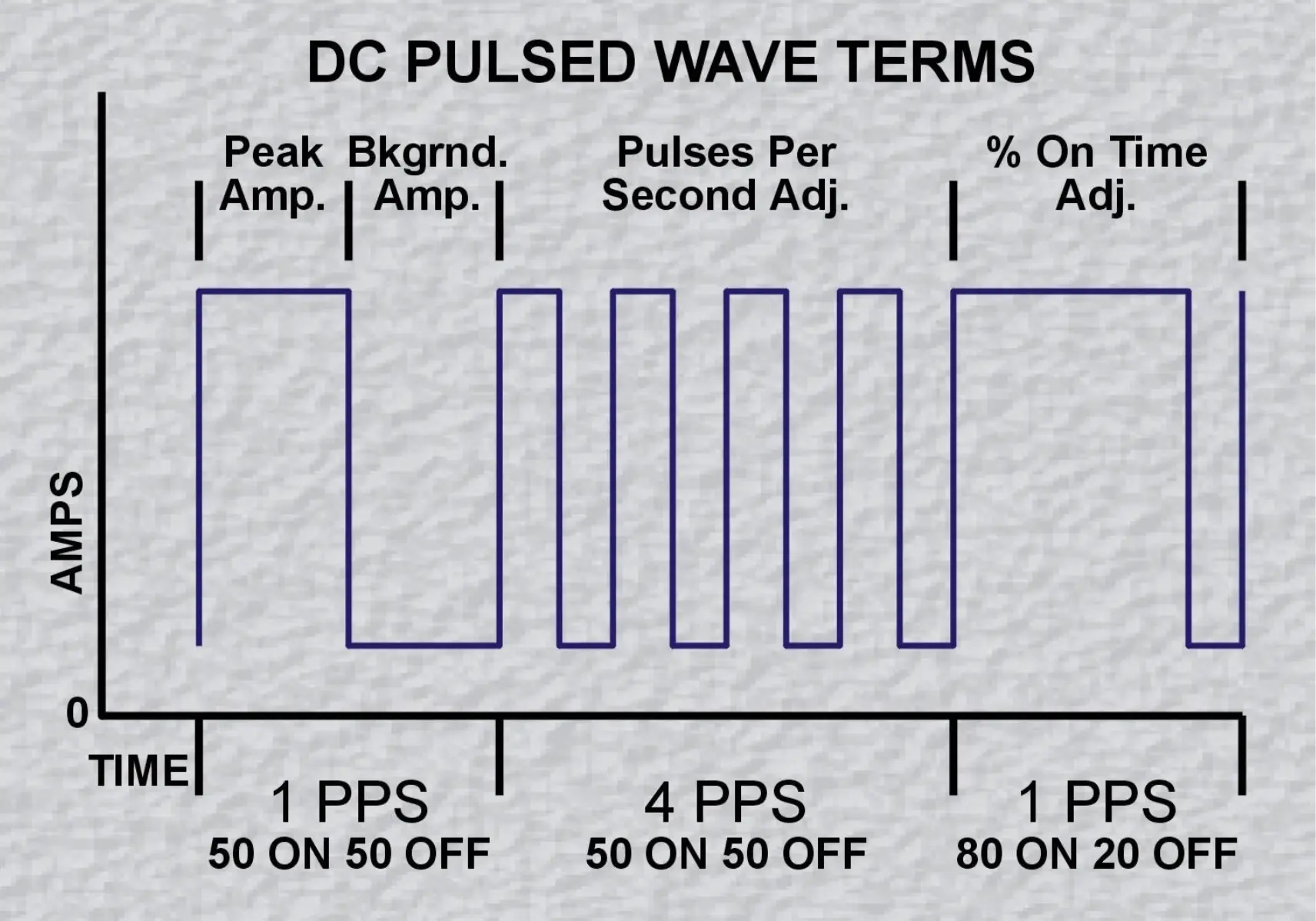

Manufacturers welding thin stainless know that pulsed TIG welding improves results. However, they may not be aware that conventional TIG technology cannot pulse faster than 10 or 20 times a second. Conversely, the newest generation of TIG inverters can pulse as fast as 5,000 pulses per second (PPS).
Higher pulsing rates increase puddle agitation, which in turn produces a better molecular grain structure (strength) within the weld. Pulsing the current at higher speeds also constricts and focuses the arc. This produces a smaller heat-affected zone; reduces the risk of carbide precipitation; and increases arc stability, penetration and travel speeds. It can also reduce scrap rates and post-weld grinding.
Pulsed TIG technology pulses the arc between a peak and a background current (see Fig. 2 above).
Increasing the number of pulses per second:

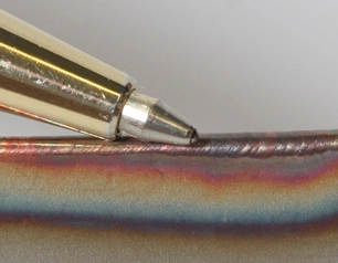

Fig. 3 Straight TIG, Pulsed TIG : The pulsed TIG weld bead took 30% less time to weld and it requires almost no clean-up. It also clearly indicates the reduced heat-affected zone.
To confirm these results, Miller developed the sample images shown in Fig. 3 above. The samples show an outside corner weld on 22-gauge 304 stainless steel made without filler metal. The straight DC TIG weld bead took 45 seconds to complete, while the pulsed DC TIG sample took 30 seconds to complete. Pulse settings were: 40 amps peak amperage, background current 20 percent of peak, 175 PPS and 75% peak arc-on time.
