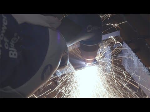

Begin cutting by placing the torch as close as possible to the edge of the base metal. Press the trigger to initiate the preflow air; the pilot arc will light, followed by the cutting arc. Once the cutting arc starts, move the torch slowly across the metal. Adjust your speed so that the cutting sparks emerge from the bottom of the metal. At the end of a cut, angle the torch slightly toward the end of the cut or pause briefly to completely finish the cut. The post flow air will continue for a short period after the trigger is released to cool the torch and consumable parts.
