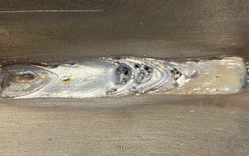

Welding produces a molten puddle made up of the base metal and filler metal being fused together. Shielding gas protects that puddle from atmospheric contaminants like nitrogen and hydrogen.
Without shielding gas, the finished weld would be very weak and peppered with pinpoint holes once it solidifies — a defect known as porosity. Shielding gas acts as a blanket over the molten weld puddle, keeping atmospheric contaminants out.
The type of gas used also has an impact on the characteristics of the weld — affecting spatter levels, arc stability, arc performance and many other factors.

A flow rate that is too low will introduce porosity into the weld because there isn’t enough coverage to protect the puddle. A flow rate that is too high wastes gas and can also produce turbulence, introducing atmospheric contaminants into the weld that cause porosity.
