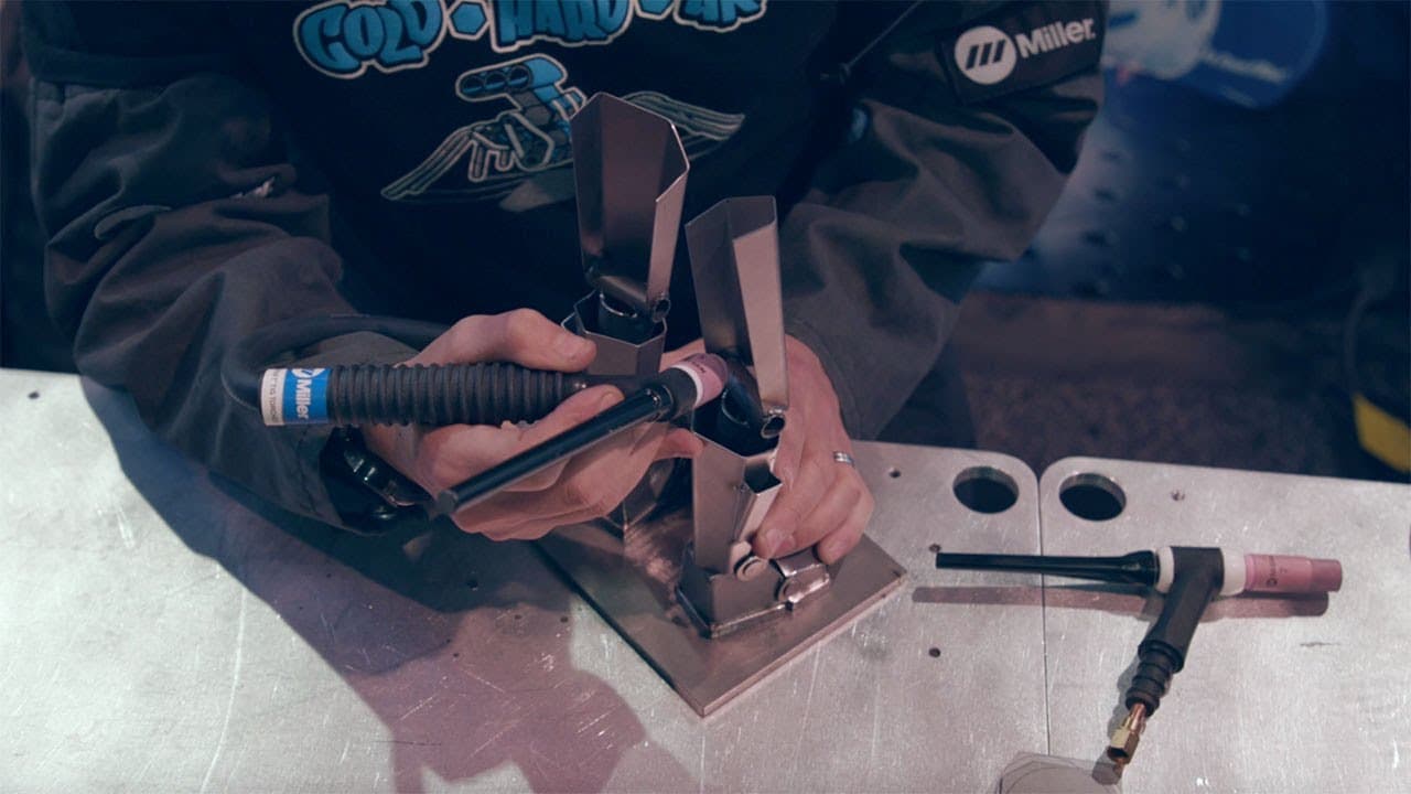

How a collet body works
A collet body has several holes that introduce the shielding gas inside the nozzle. These holes tend to be perpendicular to the nozzle, causing the gas to spiral or be more turbulent as it exits.
When using a collet body, keep the tungsten extension within the inside diameter of the nozzle.
Why choose a gas lens?
A gas lens uses multiple screens to create a more uniform laminar flow, improving the consistency of the shielding gas coverage and reducing turbulence compared to a collet body. The gas lens allows the tungsten to extend farther than the inside diameter of a standard collet body.
