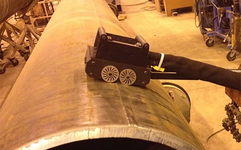

Induction heating has been around for decades, but in the past it wasn’t well-suited for roll-welded applications due to the heating cables that operators had to wrap around the pipe. However, a new rolling induction technology exclusive to Miller Electric Mfg. Co. has an inductor that sits on the pipe and does not interfere with the rotation of the pipe. The inductor operates on a standard pipe stand and connects to a ProHeat™ 35 power source.
As with standard induction heating, the new technology for roll-welded applications uses a noncontact method to quickly heat conductive metals by inducing current into the part. Induction does not rely on a heating element or flame to transfer heat. Instead, an alternating current passes through the device, creating a magnetic field around it. As the magnetic field passes through the conductive workpiece, it creates eddy currents within the part. The resistance of the metal fights against the flow of the eddy currents, generating heat in the part. The part becomes its own heating element, heating from within, which makes induction very efficient since it loses little heat in the process.

Manufacturers design rolling induction technology to be as easy and time-saving to set up as an open flame method. It’s also easy to move or reposition. The hinged arm and rolling inductor mount on a standard pipe stand, so the welding operator can align the induction head on the pipe. The power source recognizes the attachment, so users only need to set the maximum output and time. This significantly reduces setup time compared to other electric preheating systems.
Induction heating can bring the part to temperature quickly and hold the machine at a steady output, making it a good option for getting consistent temperature levels. This speed and consistency help make it an efficient heating method for welding operators.

Rolling induction technology provides steady heat output as the pipe rolls to provide more consistent heating throughout the part, reducing hot and cold spots. The technology offers a maximum preheat temperature of 600 degrees Fahrenheit in rolled applications, and it can preheat pipe 8 inches and greater in diameter. Operations can use multiple systems to heat larger diameters.
