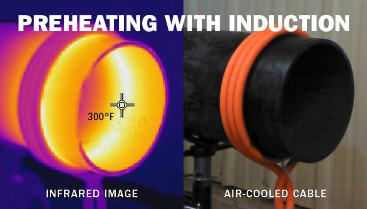

How it works: Induction creates a magnetic field that generates eddy currents within the base metal, heating it internally from within. Operators place induction accessories, such as cables or blanket, on the part to generate the magnetic field.
Pros: Induction offers quick setup, often in less than five minutes, and a fast time to temperature. Induction produces a uniform heated area – making it easy to achieve and stay within even a strict temperature window. The process is also extremely efficient and does not require personnel to watch it. Induction provides safety benefits, since the output coils don’t get hot or create an uncomfortably hot environment for welders. The process also provides the flexibility to heat many different sizes and shapes of parts. In addition, it delivers localized heating where the part is.
Cons: Induction can have a higher initial cost and requires some operator training to ensure proper wrapping techniques.
