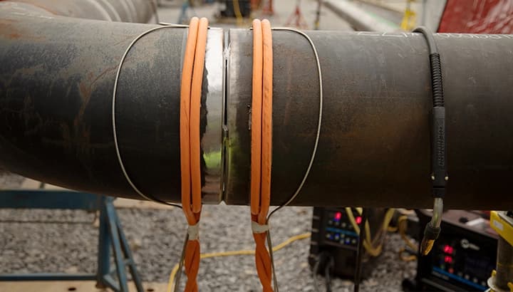

Air-cooled cables, a new heating tool for induction, deliver the same flexibility as liquid-cooled cables without the need for a cooler or liquid-cooled cable connections. This can save time and eliminate some costs in preheat applications.

Most welding preheat applications performed using air-cooled blankets or liquid-cooled cables can use the air-cooled cables from Miller Electric Mfg. LLC. Air-cooled cables eliminate liquid cooling requirements while still providing a flexible and efficient solution for welding preheat.
Operations utilize welding preheat on carbon steel that is heated up to 400 degrees Fahrenheit (204 degrees Celsius). The air-cooled cables, used with the ProHeat™ 35 induction power source, are rated for up to 400 degrees Fahrenheit in the heating zones around the weld, and they can be used with pipe diameters of 3/4 inch and up. The cables have amperage capabilities of 250 amps maximum and 200 amps continuous.
In addition, operators can bend or shape the flexible cables to best fit the pipe, flat plate or part, so they’re a solution that can meet many preheating needs.

Miller designed the air-cooled cables with materials that can withstand higher temperatures with no coolant. Operators can apply them directly onto the material being heated up to 302 degrees Fahrenheit (150 degrees Celsius). Operations can use air-cooled cables on heating applications to 400 degrees Fahrenheit with 1/2-inch preheat insulation. Liquid-cooled can go to 1,400 degrees with proper insulation.
Induction heating systems that use liquid-cooled cables are limited to cable lengths of 360 feet due to pressure losses fighting the cooler output. Air-cooled cables are available in lengths of 30, 50 and 80 feet and can be connected in series with one another using a series adapter when longer lengths are needed — making it easier to complete welding preheat in hard-to-reach areas or on larger parts. Operations can also connect multiple air-cooled cables in a series to create a longer cable for use on large-diameter parts. You can add cables until you reach running limits of the power source that will limit or stop the heat output.
