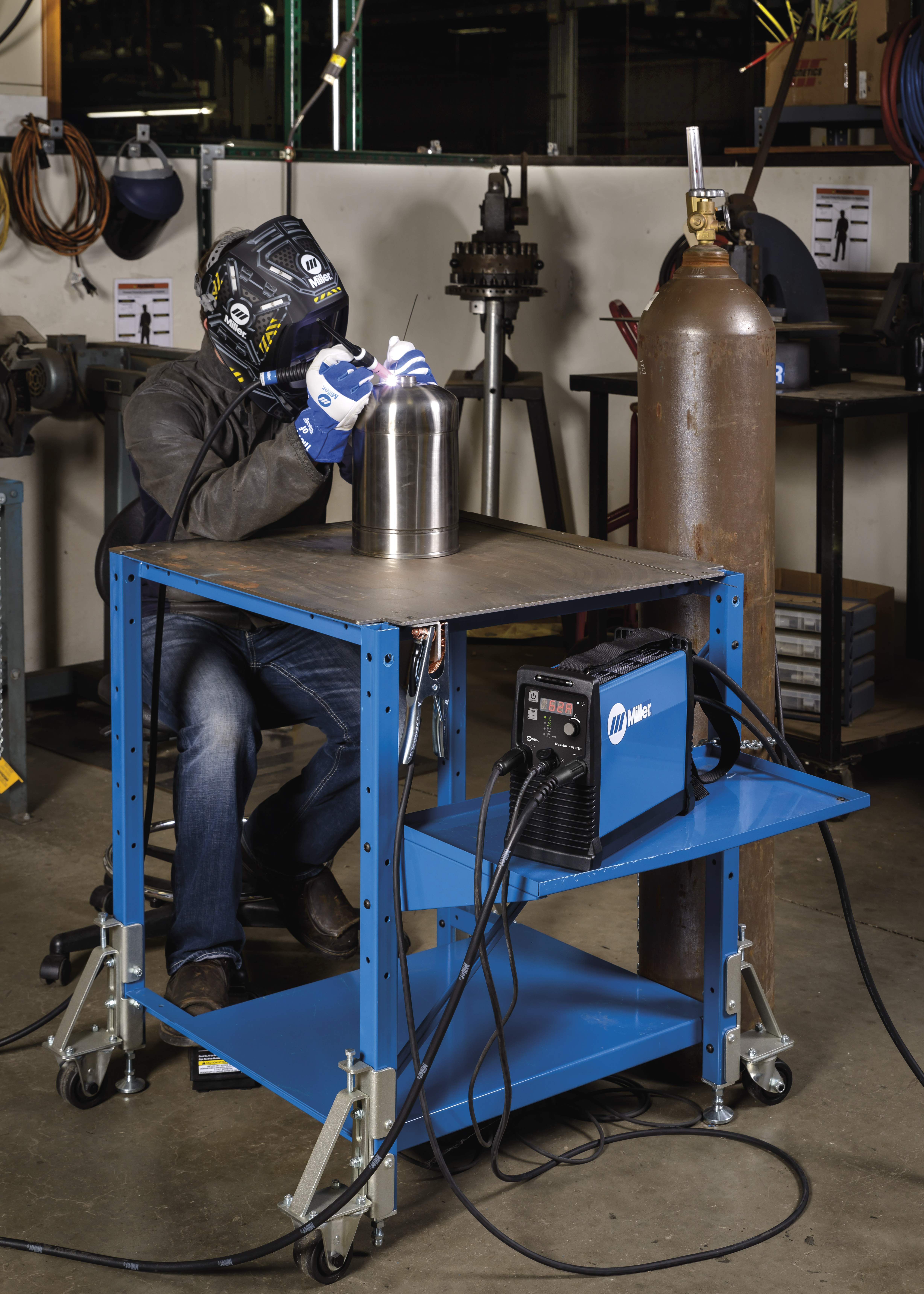

Sanitary TIG welding rewards precision. Unstable arcs, wandering starts or inconsistent amperage make it harder to control bead shape and overall heat input, especially on thin‑gauge stainless or small‑diameter tubing.

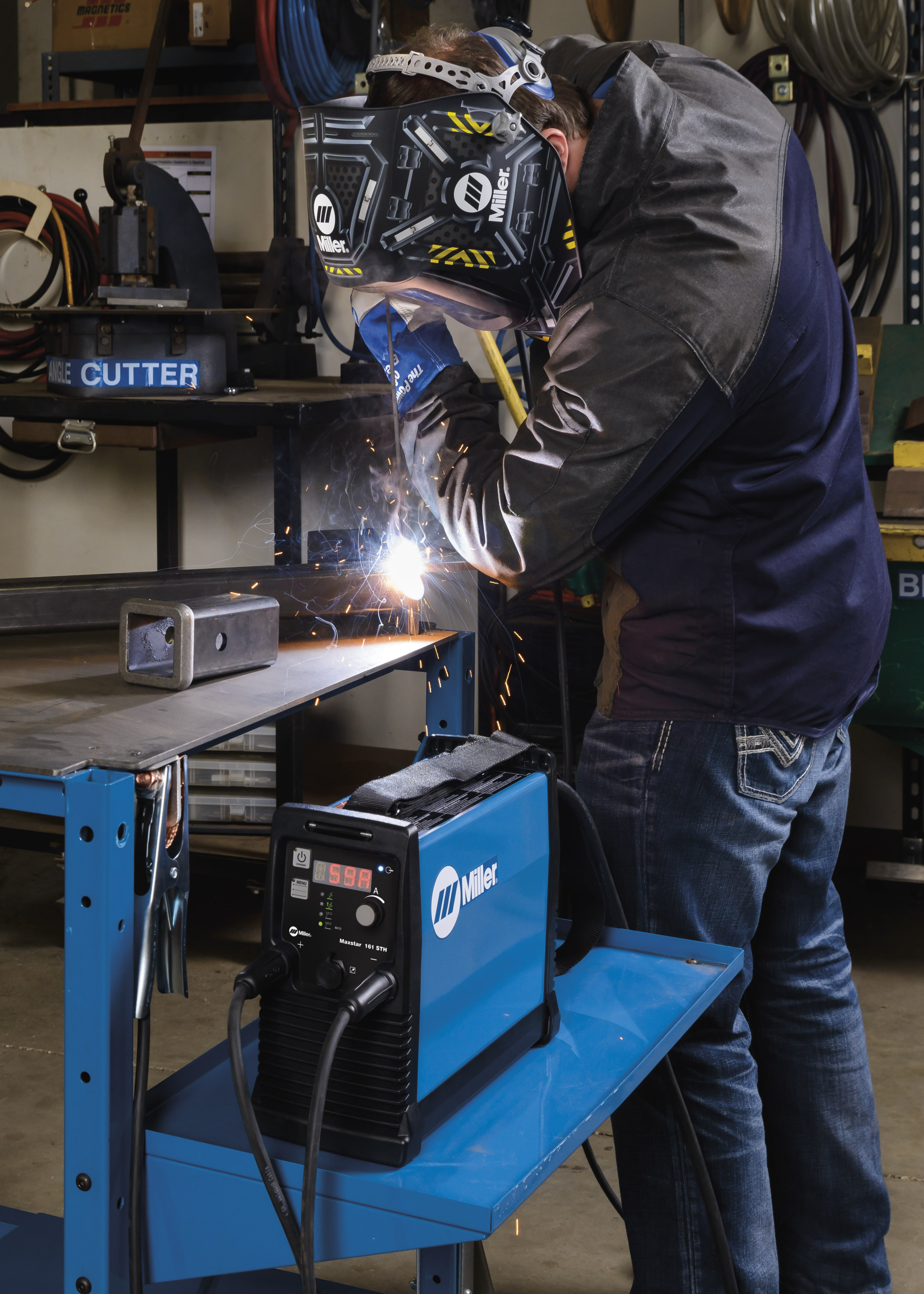

Stable arc starts allow welders to establish the puddle quickly and accurately without overusing the pedal. The faster the arc stabilizes where it’s intended, the less excess heat is introduced into the joint. That level of control becomes even more important at very low amperages. Many food‑grade stainless applications require welding at one or two amps, where even slight fluctuations can affect bead appearance, heat tint and penetration consistency. Machines like the Miller® Maxstar®, which deliver smooth, repeatable output at low amperage, give welders the ability to stay within that narrow sanitary window.

Meeting tight sanitary expectations doesn’t require changing proven TIG techniques, but it does benefit from modern machine capabilities. The Miller Maxstar, an advanced DC TIG system, provides precise amperage resolution, stable low‑amp performance and consistent arc characteristics that help welders control heat input from start to finish. Features like tailored arc‑start routines, refined high‑frequency starting and optional pulsed TIG allow welders to fine‑tune arc behavior without adding unnecessary complexity.
