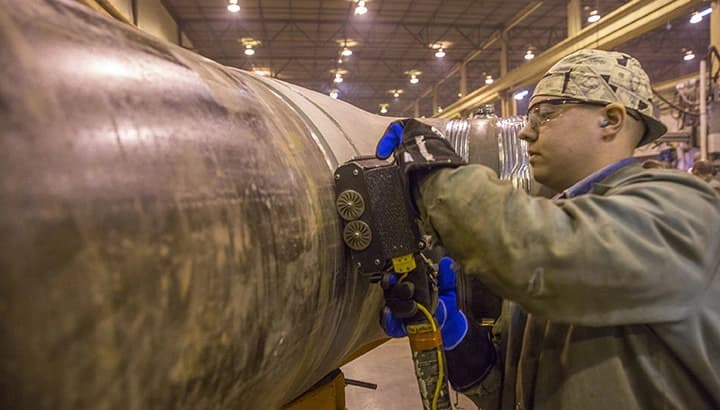

Induction heating systems quickly heat conductive metals by inducing current into the part. Induction does not rely on a heating element or flame to transfer heat. Instead, an alternating current passes through the heating device, creating a magnetic field around it. As the magnetic field passes through the conductive workpiece, it creates eddy currents within the part. The resistance of the metal fights against the flow of the eddy currents, generating heat in the part — referred to as Joule heating. The part becomes its own heating element, heating from within, which makes induction very efficient since is loses little heat in the process. In addition to Joule heating, induction generates heat in a second way through magnetic hysteresis losses. The more magnetic the material, the more hysteresis losses will occur, which results in the part heating up easier.
Applications that typically require hours to heat can take minutes by utilizing induction heating and either liquid-cooled, air-cooled and rolling options. Induction heating systems can use various tools to induce heat, depending on the part size and geometry.

Operations can use induction to preheat and stress relieve (through PWHT) P91 and other chrome moly pipe. Welding preheat procedures on these pipes is no different than on any other carbon steel pipes, though it does involve taking care to address the specific challenges of heat-treating the material.
P91 is a type of creep strength enhanced ferritic (CSEF) alloy, which are steels designed to retain strength at extremely high temperatures. While CSEF alloys are designed to maintain strength as the environmental temperature rises, one of the biggest challenges in welding P91 is the material’s sensitivity to heat changes during the welding process. This makes it critical to properly control the temperature before, during and after welding.
When heating a thick piece of pipe, high heat is necessary to get a stabilized temperature throughout the inside of the pipe, and P91 typically has higher temperature requirements during stress relief. For example, with many carbon steels it’s common to require soak temperatures of 1150 to 1250 degrees Fahrenheit; but with many grades of P91 material the necessary soak temperature range typically starts at 1350 degrees and may extend to 1410 degrees F.
Metal heated to a certain point loses its magnetic properties. The temperature level at which this happens, which can vary slightly, is called the Curie point. With many grades of P91 material, the Curie point typically happens around 1380 degrees F, so when the application calls for the material to be heated to 1410 degrees the induction heating process changes. As a result, heating from hysteresis losses goes away, the output parameters of the induction unit will change, and part temperature heating rates may slow down or stall out before it reaches the soak temperature level.
Some corrective actions can overcome the issue. First, proper setup is important and helps ensure the material heats up well. Using proper PWHT insulation for the size pipe being heated and tightly winding the coil turns onto the insulation are important steps to maintain proper coupling distance from the part to the coil.
Second, because output characteristics will change at the Curie point, it’s important to wind an appropriate coil setup for this change. Since heating hysteresis losses go away at the Curie point, Joule heating becomes the only source of adding heat to the part. To ensure reaching the desired soak temperature past the Curie point on larger pipes, consider coil windings that run at lower voltage and current levels. The easiest solution to achieve this is to use a longer cable to get four to eight more turns on the part. A better solution is to wind two coils in parallel, which results in less voltage and better utilization of the current available from the unit.
Lastly, make sure the unit’s kilowatt level is enough to heat the part to the desired soak temperature. For larger parts, you can add a second unit to reach the necessary heat levels. Cable length is not generally an issue that causes limitations in induction heating, but kilowatt range can be. This makes it important to consider the power density necessary to heat the part and the capacity of the unit. It all comes down to how much time the operator has to wait; heating up something extremely large can take a long time when the kilowatt level is not enough for the job.
